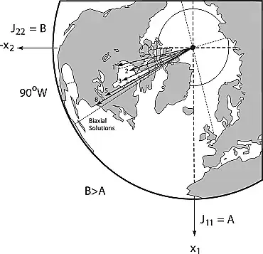

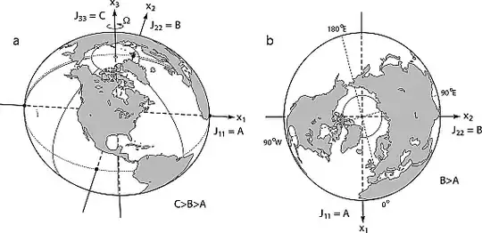

You could also take a look at some theoretical exploration of a slightly triaxial Earth in The rotational stability of a triaxial ice-age Earth where the effect is very greatly exaggerated in the images below.
Figure 5. Predictions of the present-day ice-age-induced TPW generated using the “global” loading geometry and the sawtooth loading history. The predictions are based on a rotational stability theory valid for a triaxial Earth [equations (13) and (16)] with nonhydrostatic inertia differences given by equations (3) and (4). Moreover, the calculations adopt an Earth model with an elastic lithospheric thickness of 100 km, upper mantle viscosity of 1021 Pa s, and a lower mantle viscosity of Y × 1021 Pa s, where Y is specified by the label adjacent to the arrowhead of each line. Also shown, for the sake of comparison, is the direction of TPW associated with all predictions based on the biaxial rotation theory of Mitrovica et al. [2005] (dotted line).
Figure 3. Schematics illustrating the shape and principal axis orientation of the triaxial Earth in both a (a) 3-D and (b) top view. The figures reflect, using an exaggerated scale, the relative sizes of the principal moments of inertia (A < B < C). The x3 axis is coincident with the rotation vector, while x1 and x2 equatorial axes point toward −14.93°E and 75.07°E, respectively.
