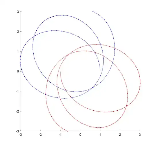

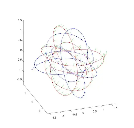

Addendum: I implemented a simple simulation of a two-body model with the Landecker, Yung and Villani forces. For two equal mass bodies adding parallel dipoles orthogonal to the orbit plane does indeed produce precession. Dipole-induced precession Giving them arbitrarily oriented dipoles produces a more complex behaviour; I think for mild cases is quasiperiodic (as are in-plane orbits with different masses). Quasiperiodic orbit For very strong interaction it looks like there can be mutual inspirals, but I am not confident this simple simulation has the numeric stability to be accurate.
