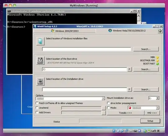

Parallels Desktop for Mac will complain of an error writing boot loader (MBR). This is OK and expected.
Marking partition as "active"
Problem
If you were to use WinNTSetup now and specify Bootdrive,
Then you may notice that BOOT FLAG indicator is inactive (red).
It should otherwise be fixed by WinNTSetup. However, some builds of WinNTSetup do not appear to perform this change for the user. Luckily, the solution is simple and easy.

In the "WinNTSetup" steps below, BOOT PART
check should now be green (passed).
WinNTSetup
Start WinNTSetup.
Ensure that BOOT PART
indicator is active (green). If not, mark partition as "active" as described above.
Begin configuring installation:
- Select a top panel corresponding to your installation Windows release (e.g. Windows 7, not Windows 2000)
- Select location to
INSTALL.WIM
file, within installation image. It is typically a large (2GB+) file within installation DVD. For example, if installation image is mounted to disk D:\

- For Boot Drive and Installation Drive locations, select partition (i.e. a drive letter) to which Windows will be installed.
- In options below: Select desired Windows Edition
- In options below: Check drive letter preassignment.
- In options below: Select Mount Installation Drive to be
C:
(otherwise, Windows may later be found on D:
The resulting configuration should look like this,
Click on "Setup". You will proceed to the next window.
In the Ready? window, observe both "Bootdrive" and "Installationdrive" being configured properly. Most importantly, ensure that for Bootsector option, Use bootsect.exe to update the boot code (default option) is selected,
Finally, click "OK" and observe WinNTSetup begin its process.
Toward completion of WinNTSetup operation, as WinNTSetup is Updating boot code, Parallels Desktop for Mac will complain of an error writing boot loader (MBR). This is OK and expected,
Note: WinNTSetup runs bootsect.exe
at this point.
Wait a bit more and observe WinNTSetup completing its process and informing that "Setup is done",
Once WinNTSetup is finished, close the program and perform a sanity check. Open WinNTSetup again and (as though you wanted to use it again) briefly go through configuration again. Once Bootdrive location is configured, ensure that all checkmarks are ticked and green,
The installation is largely complete. However, as can be inferred by errors writing boot loader, Mac will not boot to the second OS. There is no rapid way to rectify this, so you'll need to use the Mac OS recovery disk.
