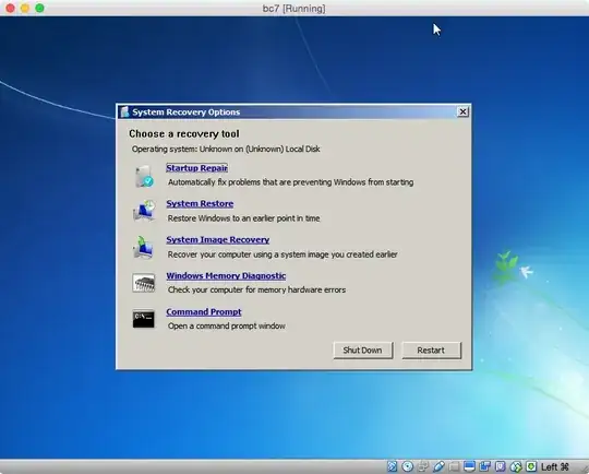

    With the button "Use recovery tools that can help fix problems starting Windows." selected, click the Next button.
    102
    Select the "Command Prompt" option.
    103

  • I believe I did everything right, even using the same version of VirtualBox mentioned. All steps seemed to have gone smoothly. When I restart in step 10 I only see the default Mac HD and no BOOTCAMP option. When I log back in to the Mac I see BOOTCAMP mounted still. I even tried step 9 again. I've so far been unable to find any clues searching around. I may start from the beginning again when I get some time. – Rafe Mar 31 '21 at 04:56
  • @Rafe: What is the model/year of your Mac? What version of macOS do you currently have installed? Which version of Windows are you installing? – David Anderson Mar 31 '21 at 05:49
  • Oh sorry! MBP Late 2011 13" intel core i5, running High Sierra (10.13.6), installing Windows 7 SP1 x64 x86 (I tried the 32bit too). Is there anything I can look for to debug the part that causes the mounted BOOTCAMP partition to show as bootable? P.S. I'm only doing this because I do not have DVD-R (and I think the burner is broken anyway). I may try the external USB stick method if this won't work but I'll wait to see if any advice shows up here before doing that) – Rafe Apr 01 '21 at 18:14
  • Other (perhaps easier) methods exist that have been created since this answer was posted. I do not think you can boot the Windows 7 installer from a USB port. I believe you can boot the Windows 10 installer from a USB port and then use commands to install Windows 7. – David Anderson Apr 01 '21 at 20:14
  • Any thoughts on how I might debug this method? To get it to show up as a boot option? – Rafe Apr 02 '21 at 17:35

  • Yes, I have used VirtualBox to install Windows to physical partition on my 2007 iMac. If you wish, I could post a tutorial where you would employ the procedure to install Windows on a virtual machine. You could then try the procedure for yourself. This should be fairly safe, since you would be only working in a virtual environment. Later, I could post how to do the same, using the physical BOOTCAMP partition on your Mac. Here, VirtualBox would only be used to copy the files to the physical partition. You would not use VirtualBox to do the physical install of Windows to the BOOTCAMP partition. – David Anderson Jan 29 '16 at 10:49
  • Thanks, I do know how to install to a virtual machine but this doesn't help me much as I require access to the gfx card. Instructions for installing to bootcamp partition would be welcome – unohoo Jan 29 '16 at 11:05
  • OK, then I should assume you have a fairly good understand of how to use the Windows commands DISKPART, XCOPY, BOOTSECT and BOOTREC? – David Anderson Jan 29 '16 at 11:48
  • You will need to first create a physical partition to hold the Windows 7 operating system. If the BCA already created this partition you can use that one. Otherwise, use the Disk Utility or other utility to create this partition. The partition should be FAT formatted with the label BOOTCAMP. Afterwards, enter the following commands in a Terminal window and post the output to your question: diskutil list, sudo fdisk /dev/disk0 and sudo gpt -r show /dev/disk0. None of these commands will change your computer. Some may ask for your login password. This is normal. – David Anderson Jan 29 '16 at 12:42
