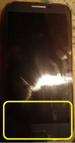

I have Star N7189 (5.5") with the lower zone of touch screen dead
Dead zone
The menu and back buttons don't work,but the physical home button works.
I tried to press hard on the edges of the screen, I tried to apply a twist from the short sides as if it were nothing but a wet towel. I did the hard reset but it did not work.
Sometimes pressing dead area, the phone takes it as menu button
As well as replacing the screen what other methods can I try? Is there any app, launcher or trick to resize the screen usable only to the working area?
P.S. a few hours after leaving it in airplane mode suddenly the touch had this problem but I do not remember if I inadvertently placed something heavy in that area of ​​the cell.

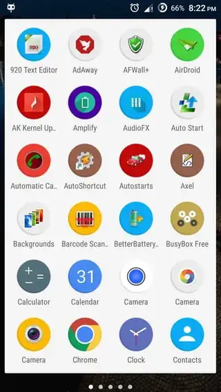

    My default launcher screen without tweaks looked like:
    IMG: Default launcher screen without tweaks
  1. To reduce the screen output at bottom issue the command:
        adb shell wm overscan 0,0,0,100
    Note the I used further reduction by upto 0,0,0,300 and the output was like this:
    [![enter image description here][3]][4]
    Tweak the value to your desired needs.
  2. You may need to correct the density since the display could look odd. My device's default display density is 480 dpi, so I tweaked it this way:
        adb shell wm density 440
    and the resultant screen was like this. An app under tweaked resolution.
  3. Note that you can use adb shell wm density reset and adb shell wm overscan reset to revert back to default density and resolution respectively.
