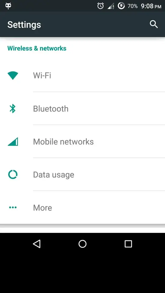

I have a oneplus android phone. The touch screen recently started malfunctioning so that the bottom centimetre of the screen does not work, but the rest of the screen works perfectly well. Unfortunately the bottom centimeter contains lots of important functions. Is there a way to resize my display or resolution so that it excludes the bottom centimeter of my screen?

      My default launcher screen without tweaks looked like:
    2. To reduce the screen output at bottom issue the command:
      adb shell wm overscan 0,0,0,100
      Note the I used further reduction by upto 0,0,0,300 and the output was like this:
      Tweak the value to your desired needs.
    3. You may need to correct the density since the display could look odd. My device's default display density is 480 dpi, so I tweaked it this way:
      adb shell wm density 440
      and the resultant screen was like this. An app under tweaked resolution.
    4. Note that you can use adb shell wm density reset and adb shell wm overscan reset to revert back to default density and resolution respectively.
    5. Now that "dead touch zone" has been taken care of it's time to use virtual/soft keys (only if you need it).
      1. Izzy has it already covered in this answer. Otherwise, you can use Gravitybox LP (for Lollipop users) or Gravitybox KK (for Kitkat users). It is an Xposed module, and require root access and Xposed Framework installed.
        Install, activate and launch Gravitybox → Navigation bar tweaksEnable Navigation bar → do a reboot, and soft-keys aka Navigation bar would be found enabled.
      2. Custom ROM like Cyanogenmod and some stock ROMs has the option to enable soft-keys(buttons) under Settings. You can use that option since it doesn't require any root access.
      3. After some further tweaks the final screen of my Android 5.0 looked like:
        IMG: After some further tweaks the final screen of my Android 5.0 looked like
We're good to go!
