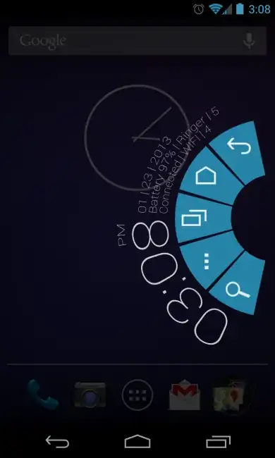

You can use LMT Launcher's PIE navigation feature to achieve your objective. LMT wouldn't replace your current home launcher which means you can rest assured that your home screen would stay untouched.
Let's come to business. Here is the XDA thread about LMT Launcher. It's a freeware app and needs to be sideloaded into the system (not available on Play Store). Make sure that Unknown Sources is enabled before you try installing its APK.
It can be activated along the edges of the screen (I prefer at bottom) like this:
(Click image to enlarge; Source: Droid Life)
IMG:
This navigation is called PIE and each of the blue section is referred as a pie.

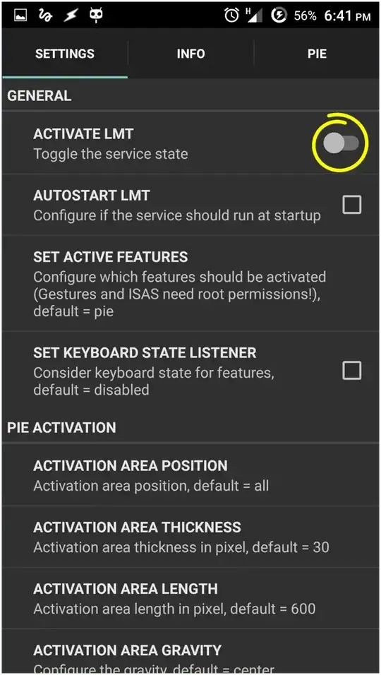

Usage Instructions
  1. Launch LMT launcher and activate it.
  2. Go to Pie → Pie Item 1 → Script and enter:
    su; input touchscreen swipe X1 Y1 X2 Y2
    Replace the coordinates with the one you produced as ideal to simulate Scroll Down.
  3. Configure another pie in the manner noted above but interchange the coordinates to X2 Y2 X1 Y1 to simulate Scroll Up.
  4. In place of Script you may select Key option and enter the keycode you want to be executed.
  5. Under Settings tab you can configure the settings of navigation system such as the place where you want the bar to show up, size of PIE's inner/outer radius, its color and so on.

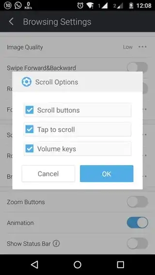

It isn't available in the Stock Android Browser or not even in Chrome. But UC Browser provides this functinality of scrolling exactly one page at a time. You can use the "Scroll Buttons" or "Tap to scroll" or the "Volume keys" feature by installing UC Browser for Android. In the UC browser Settings page you can do configure the scroll style and it resembles the same Page Up & Page Down key actions like we do in our desktop keyboards.
Scroll Buttons: A virtual Page Up and Page Down arrow buttons are added at the right hand side of a webpage.
Tap to scroll: You can either tap at the top half of the screen or th bottom half of the screen to exactly scroll one screen page at a time.
Volume Keys: You can also use your volume rocker keys to scroll the screen page one by one. Pressing the Volume down scrolls the page once downwards and pressing Volume up scroll the page once upwards.
For enabling this feature,
  • Install UC browser - Surf it Fast from the Play Store
  • Goto Settings > Browsing Settings > Scroll Options
  • Either set it to "Scroll Buttons" or "Tap to scroll" or "Volume buttons" > Press Ok
  • Now open any scrollable webpage and do the desired action based on your scroll settings. For example:
    1. If you've enabled "Tap to Scroll", then click at the bottom half of the screen to scroll down by one screen page(similar to Page Down key).
    2. Similiarly you can scroll to the top by tapping once at the top half of the screen on any scrollable webpage.
UCBrowser_Scroll_Settings_options
Screenshot - UCBrowser Scroll Settings (Click to enlarge image)
Note: You can also enable all the three options at once. But I recommend to use the "Scroll Buttons" option as it is easy to use and works fine for all pages. In Tap to scroll, clicking link will open the links and will not scroll the page up/down. So tap an area where there are no links available.

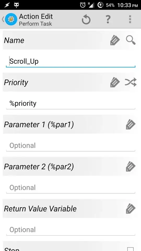

The need of using an Xposed module can be removed from my answer here. We can use Tasker and a very useful plugin named AutoInput to simulate page up/down using Volume keys.
Instructions
  1. Install both the apps.
  2. Go to Settings → Accessibility and enable Services for both Tasker and AutoInput.
  3. Launch Tasker. Under Tasks, create a task named Scroll Up.
  4. Create following actions in that task (A implies an action):
    • A1:
      • Plugin → AutoInput → Modes → Configuration → Key Suppress → Enable → Keys → scroll to select Volume Up
      • Timeout: None
      We're suppressing the Volume Key so that you don't end up with system ringer volume dialog with a slider when you press that key.
    • A2:
      • Code → Run Shell:
      • Command: input touchscreen swipe X2 Y2 X1 Y1 or input keyevent 92
        If you choose the former command, then use my answer to get the coordinates.
      • Check Use Root
  5. Create another task named Scroll Down.
  6. Create following actions in that task:
    • A1:
      • Plugin → AutoInput → Modes → Configuration → Key Suppress → Enable → Keys → scroll to select Volume Down
      • Timeout: None
    • A2:
      • Code → Run Shell:
      • Command: input touchscreen swipe X1 Y1 X2 Y2 or input keyevent 93
      • Check Use Root
  7. Under Profiles tab, create two profiles named Autoinput Up Key and Autoinput Down Key.
  8. Link the tasks Scroll Up in Autoinput Up Key and Scroll Down in Autoinput Down Key profile.
  9. Create a third task named Launch Profiles and create following actions in it:
    • A1:
      • Tasker → Profile Status → choose using lens icon Autoinput Up Key
      • Set: On
    • A2:
      • Tasker → Profile Status → choose using lens icon Autoinput Down Key
      • Set: On
  10. Create the final task named Kill Profiles and create the identical actions of step 10. Change Set from On to Off in both actions for this step. We need this task so that the custom actions meant for Volume keys doesn't affect other apps where the keys should function as normal.
  11. Create a profile based on application context and select an app of your choice, such as Chrome.
  12. Link Launch Profiles task in Chrome profile.
  13. Link Kill Profiles as an exit task in Chrome profile.
You may now launch Chrome. Use Volume Up/Down to find that they would not change the ringer volume but would scroll up/down the page you've opened up in Chrome. Switch to another app not selected in above steps or close Chrome and those hardware keys would function as normal.
Note: It's not butter smooth as my linked answer but it's not sluggish either. If you're not comfortable with Xposed framework or modules then this answer would help for sure.
We're good to go!

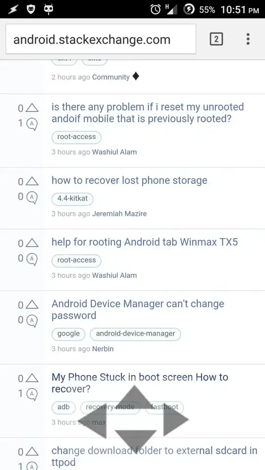

Tasker allows creation of Scenes. We can use scenes to create virtual buttons on the screen which can work as navigational keys to scroll up/down/left/right on the screen.
This answer would make good use of all of my earlier answers written on this page. It goes without saying that root access would be needed than.
(Some mundane scenes I created; click image to enlarge)
IMG: IMG: IMG: IMG:
(Excuse the drawing because I'm no good in it and neither I've tasted the power of scenes yet. Nevertheless, you can see how they are acting as navigational keys.)

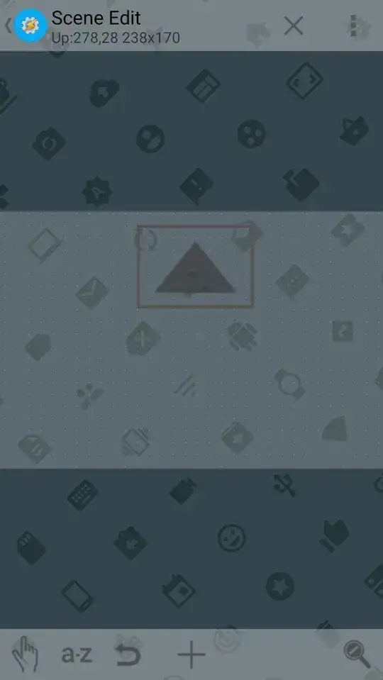

Instructions for creating Scenes
  1. Install and launch Tasker
  2. Go to Scenes tab and create a new scene named Nav Buttons.
  3. See Image 1, 2, 3, 4, 5. Note that you need not to bother about where the scene would show up on the screen since we would configure it later. Simply decide how much space your Scene should be taking on the screen.
  4. Under Tap create an action that you want to execute when the associated element is touched. You may choose to select an already existing task which may page up or swipe down the displayed app's page. See my answer here to know how to create swipe up/down tasks or see this answer to see KeyEvents which can do page up/down.
  5. Optional: If you want to destroy the scene from inside the scene then you may consider adding an action under Long Tap to kill the scene or the app.
    • Scene can be destroyed using the action Scene → Destroy Scene → select the Scene using lens icon.
    • Alternatively, if you decide to create an app from this Scene (later on the app creation part) then create the action Code → Run Shell,
      • Command: am force-stop <PKG_NAME>
        Create a unique <PKG_NAME>, such as com.user.android.se and keep it noted somewhere since we would need it in app creation.
      • Check Use Root
  6. See Image 8, 9, 10, 11.
(Click image to enlarge; hover to know details)
IMG: 1 IMG: 2 IMG: 3 IMG: 4 IMG: 5 IMG: 6 IMG: 7 IMG: 8 IMG: 9 IMG: 10 IMG: 11 IMG: 12 IMG: 13 IMG: 14

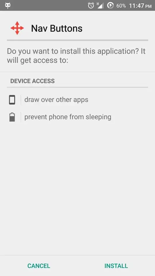

You may use Tasker App Factory to transform a task into a full-fledged standalone app (read: Tasker independent) which can be sideloaded into system just like any other app and would work as if you're executing a task using Tasker itself.
The good part is that app creation using Tasker and Tasker App Factory is legal, so one can distribute it at his/her own will.
You want more! Right. The biggest hurdle of depending upon commercial apps is pretty much solved in this particular case. If you do not own or do not want to buy Tasker but a person known to you has it, then you may kindly request that person to create an app for you. You may stick to the basic approach needed for navigational buttons mentioned in the current answer or give a chance to your own imagination.
Also, one more goodie. You can use that new app with any of the five options that I've listed for a Tasker scene. I've successfully tested all of them.
Create an app from a task in Tasker

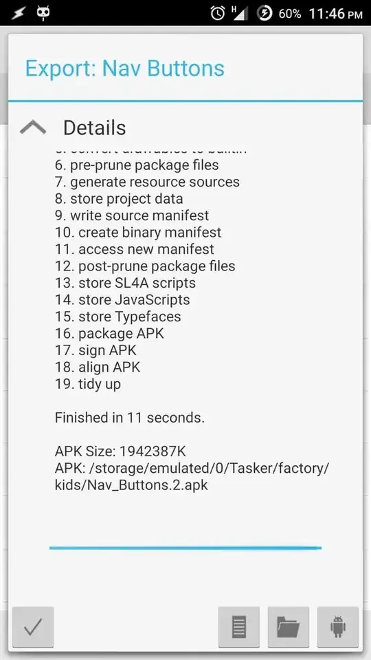

  1. Install Tasker App Factory
  2. Under Tasks tab touch and hold your task entry and tap the three dotted line → Export → As App.
  3. Create a unique package name for the app, such as com.unique.package.name.
    Note that if you completed Long Tap step during Scene creation then you must use the same package name here.
  4. You would see app creation detail. Try the icons at the bottom. The Android icon would initiate sideloading the newly created app using Android's Package Installer.
    The app, once created, would be saved under Tasker/factory/kids/ which is located in your default storage.
    Also, the name of the app (seen in launcher after installation) and its icon would be same as the name of the Task and icon you selected in the task creation under Tasker.
I've created a demo app based on the current answer, hosted on my Google Drive. Find it here. The permissions it require are:
(Superuser permission isn't listed but is definitely required.)
IMG: 1
(App icon made by Freepik from Flaticon, is licensed under CC BY 3.0)
