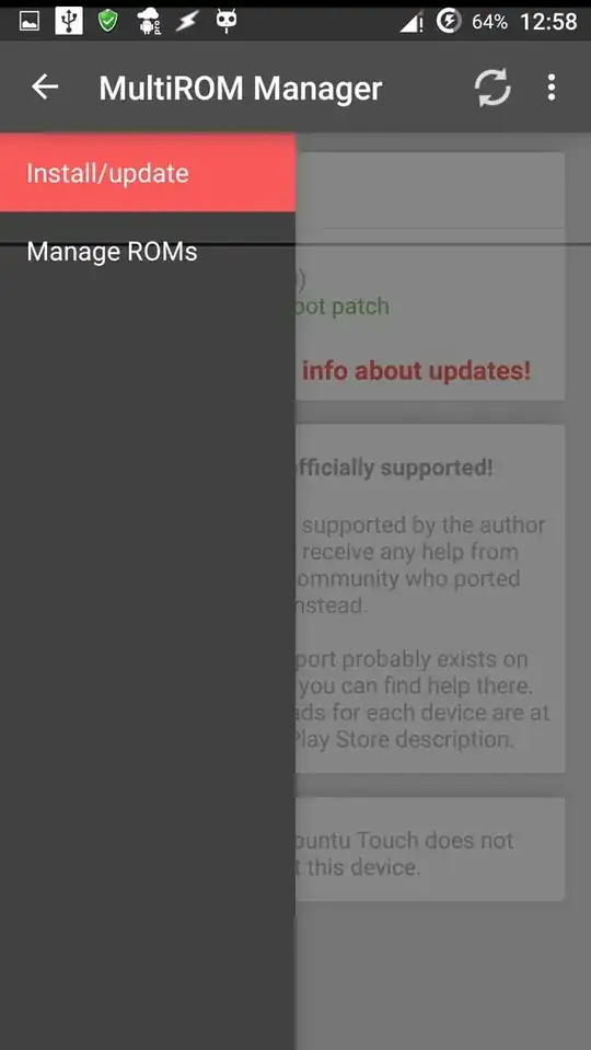

I later realized that the major inconvenience in my solution, the touch input, can be stopped if I use Tasker's scenes in overlay blocking mode.
(Click image to enlarge)
IMG: IMG: IMG:
I created several blank scenes and configured task to display them in such a way, that only a small fraction of screen can send touch input to app (fraction is allowed because I need to do input tap). The Manage ROMs window works well with DPAD key events so I used Task → Input → Dpad to reach my preferred ROMs entry and tap it.
