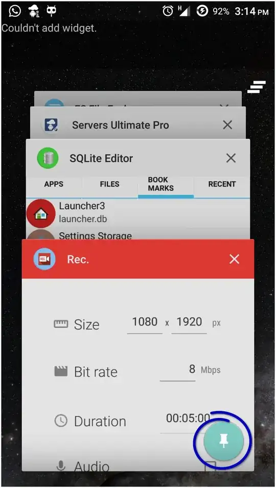

I'm aware that I can go to Settings → Security → Screen pinning → On, and then tap Overview → touch the pin icon on the app listed there and it would be pinned, effectively putting the app into .
(Click image to enlarge; hover to know details)
IMG: An app in focus IMG: Pin icon to pin the app IMG: Screen pinned app
But how do I pin an app using command line? I tried input command but with no success.
