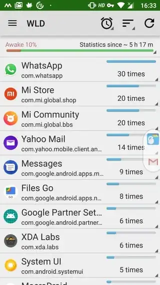

While 2 hours is enough to gather the information about top culprits, longer duration obviously leads to more data. During data collection, don't use the device and let it be as you would normally use the phone (with data or WiFi connected as is your normal usage). Screenshots below from my device (not under test but normal usage).
Left to right, they show Screen Wakelock, CPU Wakelock and Wakeup triggers. Check the top contributors to understand what's draining your battery.
enter image description here enter image description here enter image description here

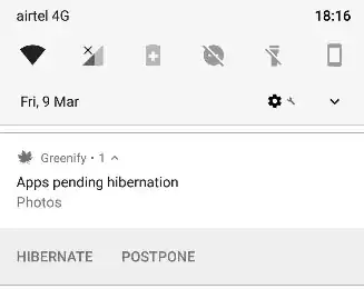

I will restrict to snapshots of settings from my device to help set it up faster after running adb commands above. I have pro version so ignore those donation settings
With those settings, even when the device is running, you will see a hibernation alert in your status bar with the app icon and in your notification panel. Clicking on that will force close and hibernate the app
You can also hibernate errant apps from Wakelock Detector by long pressing on the app
