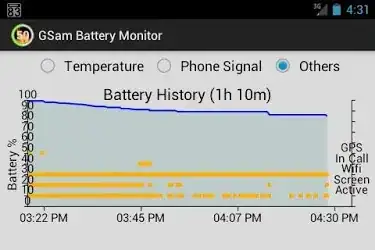

If your device does not offer this screen (or the bars at the bottom: I just discovered e.g. the LG Optimus 4X running Android 4.0.3 has cut these bars off), you can find them e.g. using GSam Battery Monitor:
Similar information from GSam Battery Monitor -- here the mentioned "blue bars" are yellow/orange
