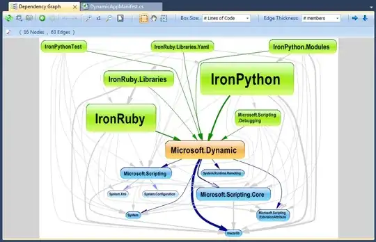

One important thing to do is to use tooling to generate dependency graphs to top-down explore code architecture. First visualize graph between .NET assemblies or jars, this will give you an idea on how features and layers are organized, then dig into namespaces dependencies (inside one or a few relatives .NET assemblies or jars) to have a finer grained idea of code structure and finally you can look at classes dependencies to understand how a set of classes collaborates to implement a feature. There are several tools to generate dependency graph, like NDepend for .NET for example, that generated the graph below.
    There are countless of tools that can create readable dependency graphs with some sort of hierarchy, but this doesn't seem like one of them. I also work with electronic design, and for that there's a rule of thumb (literally): if I have to follow a line your schematic with my finger at any point, it is a bad schematic. –  Jun 28 '11 at 11:10
