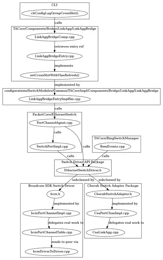

Interestingly, refactoring is the most efficient way I've found to understand code like this. You don't have to do it cleanly at first. You can do a quick and dirty analysis refactoring pass, then revert and do it more carefully with unit tests.
The reason this works is because refactoring done properly is a series of small, almost mechanical changes, that you can do without really understanding the code. For example, I can see a blob of code that's getting repeated everywhere and factor that out into a method, without really needing to know how it works. I might give it some lame name at first like step1 or something. Then I notice that step1 and step7 seem to frequently appear together, and factor that out. Then suddenly the smoke has cleared enough that I can actually see the big picture and make some meaningful names.
For finding overall structure, I've found creating a dependency graph often helps. I do this manually using graphviz as I've found the manual work helps me learn it, but there are probably automated tools available. Here's a recent example from a feature I'm working on. I've found this is also an effective way to communicate this information to my colleagues.
dependency graph
