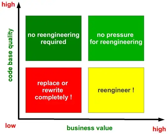

This graphic could help, it's a function of code base quality and business value of the application:
The chart pretends to be a guide on when a re-engineering of legacy software is justified and when it's not. For example, if the software has high business value and the quality of the code is poor, then a re-engineering is justified.

    Why would you invest in rewriting a project with low business value? Just scrap it! – Jørgen Fogh Jun 07 '16 at 08:41
  • That's why it statess "replace or...". You can replace with something that has value. Or make it into something that has value. But you have a point. I'll edit it to add the "scrap it" option. – Tulains Córdova Jun 07 '16 at 10:45

To decide the point at which you should start over, you need to work out where the value of continuing on your current project falls short of the value in starting over.
The reason this is so difficult is that you make an accurate estimation of the team's development velocity on the new project until you actually start it. That said, if, using a VERY conservative estimate of your development velocity on the new project, the project is estimated to give a worthwhile return on investment, then you have a business case for starting afresh.
