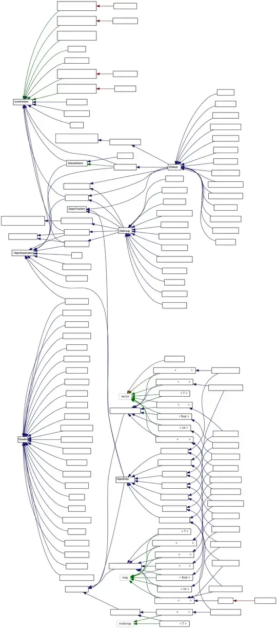

Our team has recently inherited a relatively large project from another company (~250k lines). It was developed using C++Builder and we intend to port the Ui side to Qt. Most of the Ui code is separate from the business logic (yay!) but the logic side is quite a mess.
There is a lot of diamond inheritance going on (virtual inheritance thankfully) but it makes understanding the code quite difficult to do.
We've got very little documentation to go on, what's there is out of date (comments included).
I generated class diagrams using Doxygen, here's the most complex one (I had to remove most of the class names but kept some of the more important ones and kept the standard C++ data types and std classes, yes, they inherit from std)
confusing inheritance
So far we've been able to convert the base program to Qt and we're at a point where we can start converting the program's functionality bit by bit. Problem is, is it worth it long term? We would like to be maintaining this software as our own long term.
Is there a general approach we should take to untangling this kind of inheritance mess or should we simply redesign from scratch and only keep bits and pieces of the existing code as we go?

  • Redesign by encapsulation. The diamond inheritance suggests there is not enough isolation of the independent functionality. Just as encapsulation helps one refactor a global state machine and increases the ability to understand a system by requiring only that one understand the interfaces of the encapsulated black boxes and not the implementation, further breaking down the classes is the same on a smaller scale. – DaveMorganTexas Aug 21 '15 at 00:27

If you re-write & re-design from scratch, you're going to have two MASSIVE problems:
  1. You don't have a spec. You might think you have a spec, but it turns out that the REAL spec is the old code. So you're going to have to dig into it to figure out what it really does, just so you know what to make the new system do.
  2. You'll have a long period (looking at that class hierarchy, possibly years) in which you won't have a saleable product. Which means you either have to maintain the old one in parallel, or give up on shipping anything for a long time.
It stinks, but you probably need to just try to make the old one better. Write tests for everything you touch, don't hesitate to rip out a big section to make it better, but don't try to re-write it all at once. The project may not survive such an attempt.

    I agree. There is little that can be done. The only way to make use of an old program is to understand it in its entirety. Before you can rewrite an old program, you have to first make use of an old program. – Neil Sep 17 '13 at 14:14
Rewriting a project of this size is doomed to fail due to the reasons in Michael Kohne's post.
Refactoring a buggy codebase is difficult because you'll never know if bugs are due to your refactoring or due to the original code.
I would take the approach of doing nothing but bug fixes for a significant period of time. As part of these bug fixes, you can rewrite small sections that are blatantly wrong. The benefits of this are:
  1. Gives the developers the opportunity to learn a lot about the code, architecture, and product behavior. You will need this knowledge to do any significant refactoring.
  2. Stabilizes the codebase prior to any major restructuring work.
  3. You can sell the stabilized product while major changes are made later.
It also sounds like you desperately need a bug tracking system and some sort of QA to find bugs & verify fixes.

When I've implemented large scale re-factoring on projects, I've generally used the strategy of doing the architecture afresh, and proving the architecture first, whilst development continues on the original project. When the new architecture has been proven, there is a large amount of transferring existing logic to the new architecture. This seems to be best done quickly, rather than as a background task.
Is it worth doing? That's a difficult one to judge without being there on the project but think about these issues:
  1. Is the existing code base stable and bug free? If you are having to spend significant time finding and patching the existing code without really understanding it, the time saved by a reduction in support by reimplementing using understood code can be significant.
  2. Do you have at least as much knowledge of the product as the original coders? How much of the complexity is due to bug fixes for unexpected situations, and how much was poor design?
  3. Do you have the time to finish the task? One of the things I value most about a code base is consistency. Inconsistent code is a nightmare to support, extend and introduce to new members of the team.
  4. If you have not got a substantial understanding of the products business rules, you are likely to do worse job than the current version.
Conclusion - based on the questions updates, is that you do not have enough knowledge of the project to do a re-implementation. In your current situation, even doing a significant re-factor is risky. The good news at least, is that the current customers are not hit with bugs that prevent them from using the product, which means you have time to understand the code base. This needs to be your first goal.

When looking at large scale projects (specially the ones you haven't worked on), It is very important to realize one thing. Nobody should expect you to fully understand it. You should live by the mantra of divide and conquer. That is the technique I have always used it has yet to let me down.
Consider yourself a surgeon presented with a patient who has multiple severe injuries that require your attention. Lets say you have some infection in a wound in the leg. This would be analogous to a bad library/code you want to get rid of from your code. You'd first try to establish the extent of the infection. The analogy is a quick grep to see how many files actually use that library/code and what is the nature of use. This is a significant step in the whole process and usually the most cumbersome. But after doing this what you accomplish is the identification of your boundaries and these are key. Once you know the extents you can apply anesthesia appropriately (assuming local anesthesia as it better suits the example). In terms of code, this could be interfaces at the appropriate places close to the boundary, unit tests etc. Building interfaces and creating unit tests at the boundary lets you mark your boundary. After marking your boundary, you should be more or less free to attack the infection/bad code which every way however way you like while your interfaces and boundary unit tests ensure that you never lose your way. Once done with all the modifications within your boundary i.e: all the denting and painting, your application should behave as it did without having any knowledge what so ever of any any operation ever taking place.
You then repeat this whole process for the next library/bad piece of code until you target them all. So in summary picking your battles and localizing your focus is paramount, when tackling the big ugly beasts of such nature. Good luck.
