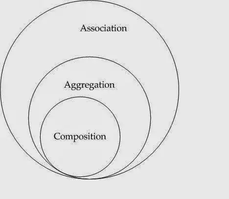

32
  • Composition is an Association
  • Aggregation is an Association
  • Composition is a strong Association (If the life of contained object totally depends on the container object, it is called strong association)
  • Aggregation is a weak Association (If the life of contained object doesn't depends on the container object, it is called weak association)

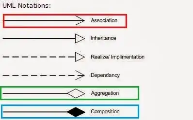

Both denotes relationship between object and only differ in their strength. enter image description here
UML notations for different kind of dependency between two classes enter image description here
Composition : Since Engine is part-of Car, relationship between them is Composition. Here is how they are implemented between Java classes.
