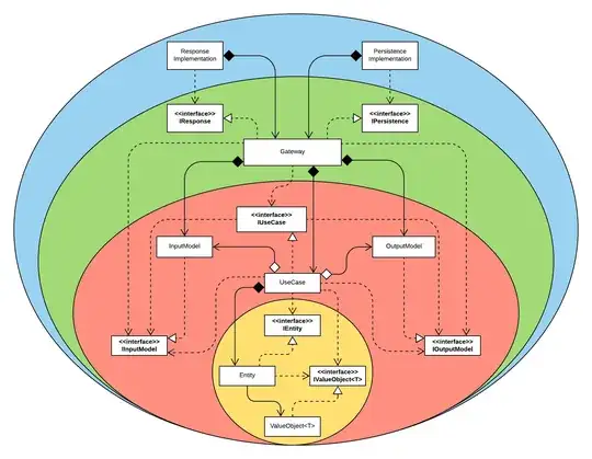

Before going further on this question, to give you guys some more background, here is my architecture (NOTE: still incomplete):
My Clean Architecture Proposal
The rules I am following in this architecture is:
  1. A layer can only know about its immediate innermost neighbor layer's interfaces
  2. A layer cannot know anything about any outermost layer
  3. All communications between layers MUST be done through interfaces
  4. Each layer must be independently deployable
  5. Each layer must be independently developable
To better understand the arrows in this diagram, I recommend reading those Stack Exchanges's questions:
