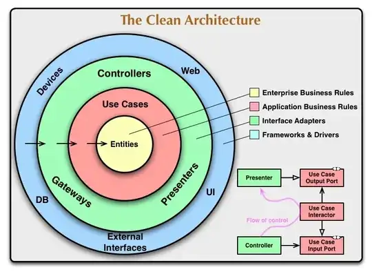

When you hear the words "higher" and "lower" understand those terms were developed when the style was to keep all inheritance arrows pointing up. These round diagrams make that metaphor a little meaningless. Here's a diagram that tries to give them meaning again:
This doesn't change your design at all. Just gives those words meaning again.
