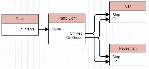

  • Would a better 'not a TDA' example be one where the traffic light code is refactored so that the if condition moves inside the TrafficLight class? And the calling code just becomes trafficLight.refreshDisplay() – bdsl Feb 14 '18 at 20:40
  • @bdsl: Possibly, but since all I'm illustrating is that you can return a value without violating TDA, I didn't include that level of detail in my example. – Robert Harvey Feb 14 '18 at 20:57
    @bdsl - And now you've inadvertently pointed out exactly where every discussion of this type goes with your trafficLight.refreshDisplay example. If you follow the rules, you lead to a highly flexible system that nobody but the original coder understands. I'd even bet that after a couple years hiatus even the original coder probably won't understand what they did either. – Dunk Feb 14 '18 at 23:17
  • How do I separate the traffic light from the colour-change timer withuot breaking TDA? I can give the traffic light method ChangeColorWhenReady(Color newColor, ReadinessDecider decider); where ReadinessDecider is a one-method interface with bool DecideIfReady(Color color, Time elapsedTime), but that seems sort of silly. – Joker_vD Feb 15 '18 at 04:31
    "Silly", as in "Do not open the other objects and look not at their guts but instead spill your own guts (if you have any) into the other objects methods; that's The Way"-silly. – Joker_vD Feb 15 '18 at 04:37
  • @Joker_vD: TDA does not require that you abstract behavior into a separate class and inject it. Quite the opposite, in fact. – Robert Harvey Feb 15 '18 at 05:36

With respect to trying to avoid return statements outright, I tried to mull over this for the past hour or so and basically stack overflowed my brain a number of times. I can see the appeal of it in terms of enforcing the strongest level of encapsulation and information hiding in favor of very autonomous objects that are merely told what to do, and I do like exploring the extremities of ideas if only to try to get a better understanding of how they work.
If we use the traffic light example, then immediately a naive attempt would want to give such traffic light knowledge of the entire world that surrounds it, and that would certainly be undesirable from a coupling perspective. So if I understand correctly you abstract that away and decouple in favor of generalizing the concept of I/O ports which further propagate messages and requests, not data, through the pipeline, and basically inject these objects with the desired interactions/requests among each other while oblivious to each other.
The Nodal Pipeline
And that diagram is about as far as I got trying to sketch this out (and while simple, I had to keep changing it and rethinking it). Immediately I tend to think a design with this level of decoupling and abstraction would find its way becoming very difficult to reason about in code form, because the orchestrator(s) who wire all these things up for a complex world might find it very difficult to keep track of all these interactions and requests in order to create the desired pipeline. In visual form, however, it might be reasonably straightforward to just draw these things out as a graph and link everything up and see things happening interactively.
In terms of side effects, I could see this being free of "side effects" in the sense that these requests could, on the call stack, lead to a chain of commands for each thread to perform, e.g. (I don't count this as a "side effect" in a pragmatic sense as it is not altering any state relevant to the outside world until such commands are actually executed -- the practical goal to me in most software is not to eliminate side effects but defer and centralize them). And furthermore the command execution might output a new world as opposed to mutating the existing one. My brain is really taxed just trying to comprehend all this however, absent any attempt at prototyping these ideas. I also didn't try to tackle how to pass parameters along with the requests in favor of just trying a timid approach at first of thinking of all of these requests as nullary functions with a uniform signature/interface.
How it Works
So to clarify I was imagining how you actually program this. The way I was seeing it working was actually the diagram above capturing the user-end (programmer's) workflow. You can drag a traffic light into the world, drag a timer, give it an elapsed period (upon "constructing" it). The timer has an On Interval event (output port), you can connect that to the traffic light so that on such events, it's telling the light to cycle through its colors.
The traffic light might then, on switching to certain colors, emit outputs (events) like, On Red, at which point we might drag a pedestrian into our world and make that event tell the pedestrian to start walking... or we might drag birds into our scene and make it so when the light turns red, we tell birds to start flying and flapping their wings... or maybe when the light turns red, we tell a bomb to explode -- whatever we want, and with the objects being completely oblivious to each other, and doing nothing but indirectly telling each other what to do through this abstract input/output concept.
And they fully encapsulate their state and reveal nothing about it (unless these "events" are considered TMI, at which point I'd have to rethink things a lot), they tell each other things to do indirectly, they don't ask. And they're uber decoupled. Nothing knows about anything except this generalized input/output port abstraction.
