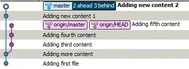

  • You have a clone of a git repository
  • You have some local commits (commits that have not yet been pushed anywhere)
  • The remote repository has new commits that you have not yet reconciled
So something like this:
Unmerged commits

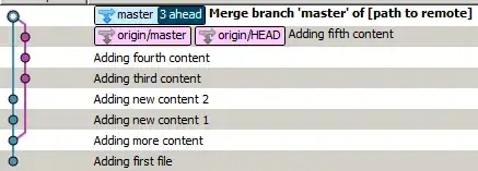

If you execute git pull with the default settings, you'll get something like this:
merge commit
This is because git performed a merge.

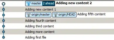

There's an alternative, though. You can tell pull to do a rebase instead:
git pull --rebase
and you'll get this:
rebased
In my opinion, the rebased version has numerous advantages that mostly center around keeping both your code and the history clean, so I'm a little struck by the fact that git does the merge by default. Yes, the hashes of your local commits will get changed, but this seems like a small price to pay for the simpler history you get in return.
By no means am I suggesting that this is somehow a bad or a wrong default, though. I am just having trouble thinking of reasons why the merge might be preferred for the default. Do we have any insight into why it was chosen? Are there benefits that make it more suitable as a default?
