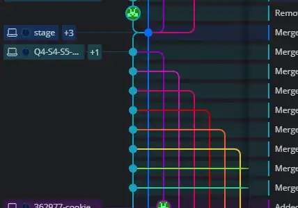

People want to avoid merge commits because it makes the log prettier. Seriously. It looks like the centralized logs they grew up with, and locally they can do all their development in a single branch. There are no benefits aside from those aesthetics, and several drawbacks in addition to those you mentioned, like making it conflict-prone to pull directly from a colleague without going through the "central" server.

    You make it sound like it's just cosmetic, but it's actually practical: it's much easier to understand what's going on in a linear history than from a complicated DAG with lines crossing and merging. – Daniel Hershcovich Nov 21 '13 at 19:44
    So use one of git log's gazillion history simplifying options, and you can make it look nice and simple. If you rebase, most of those are no longer available to you. You're forced to the one simplification and cannot see the more complex view even if you wish. – Karl Bielefeldt Nov 21 '13 at 20:04

    "There are no benefits aside from those aesthetics" — I don't know about that. It's really hard to understand what's going on in your history when your history looks like a circuit board. (Assuming multiple team members, each with their own branches and workflows.) – Archagon Nov 29 '13 at 11:31

    This answer is just plain wrong. Sure it looks prettier, that's because the history is much easier to understand when it is linear. A linear history makes many things like cherry-picking, reverting or bisecting are so much simpler with a linear history. – lukad Jan 21 '20 at 13:24
