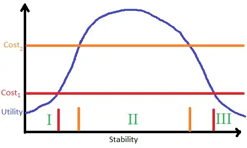

25
There is a trade-off between the cost of writing unit tests, and the value they add. Neglecting this risks the possibility of over-testing.
blueberryfields touched on one variable that affects the value of unit tests: stability of the project (or pace of development). I'd like to expand on that.
The value to having unit tests roughly follows the following plot (yay, MS Paint!):
utility vs stability
  1. In the first zone, the code is unstable to the point that unit tests will often need to be rewritten or entirely scrapped. This might be a prototype that you know won't be used. Or it might be a project where you are new to the programming language or framework (and are often needing to redo large amounts of code).
    Unit tests are good for refactoring at the module level (i.e. changing functions). The problem is when code is unstable at the architectural level, where entire modules might be rewritten, removed, or completely redesigned. The unit tests then must be changed/removed/added, which is a burden.
    At this stage, limiting to system level integration tests, or even manual testing is a better approach (which one you choose again being dependent on the cost of writing the test vs. the value you get).
  2. The unit tests add the most value in the second zone, where code becomes stable above the module level, but not yet at the module level. If you have a stable codebase, and you are adding a module that has a high chance of staying, this is when unit testing is a big win.
  3. Unit tests also begin to have less value when the stability of the code under test is very high. Testing a simple wrapper of a standard library function is one example where unit testing is overkill.
    If a piece of code you are writing will likely never need to change, and you are confident you've got it right (maybe it's super simple?), there is less value to testing.
Unit testing becomes beneficial when the utility is greater than the cost, as shown in the below graph in zone II.
utility and cost
This cost line could be at different levels for different people (line 1 vs line 2). If you are new to the test framework used in a project, this increases the level, and makes the net utility less. A higher cost (line 2) shrinks the range that unit testing is appropriate.
The cost line doesn't necessarily need to be flat. Especially when you consider other variables such as project size, and whether a test framework already exists for the project, this might be so.

    Great answer - testing is least valuable in fast-moving projects with unknown requirements, and also slow-moving projects with very stable code. Given that most of my work is in the former, this gels with me - but also makes clear that we need to get testing happening as things stabilise. – Steve Bennett May 06 '12 at 15:14
    Actually, testing can help in fast-moving projects - but you must be more careful about what you test. You cannot test things where you have not yet decided what the right result is :-). – sleske May 09 '12 at 08:56
    @sleske: Yes, but fast-moving projects tend to lack the specific (and stable) requirements that you can unit test for. Often, all that's known is the higher level requirements, which lend more to integration tests. – jakesandlund May 09 '12 at 17:43
    This is an outstanding answer. It addresses the trade-offs involved in choosing a testing strategy in a measured and results-oriented way. – Benjamin Hodgson Sep 28 '14 at 21:39
