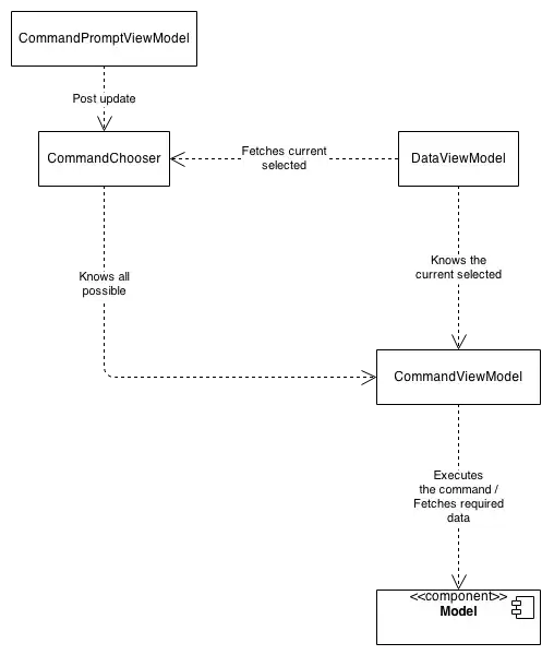

Responding to the questions one example where the design was good,but I needed a huge refactoring for the next requirement:
At first there were some requirements to execute certain commands. I wrote an extendable command parser - which parsed commands from some kind of command prompt and called the correct one on the model. The result were represented in a view model class: First design
There was nothing wrong here. All classes were independent from each other and the I could easily add new commands, show new data.
The next requirement was, that every command should have its own view representation - some kind of preview of the result of the command. I redesigned the program to achieve a better design for the new requirement: Second design
This was also good because now every command has its own view model and therefore its own preview.
The thing is, that the command parser was changed to use a token based parsing of the commands and was stripped from its ability to execute the commands. Every command got its own view model and the data view model only knows the current command view model which than knows the data which has to be shown.
All I wanted to know at this point is, if the new design did not break any existing requirement. I did not have to change ANY of my acceptance test. I had to refactor or delete nearly EVERY unit tests, which was a huge pile of work.
What I wanted to show here is a common situation which happened often during the development. There were no problem with the old or the new designs, they just changed naturally with the requirements - how I understood it, this is one advantage of TDD, that the design evolves.

Unit test are also good for the design.
Yes, designing with testability in mind will make the design better.
The problem was that over one half of the development time as for writing / refactor tests. So in the end I did not want to implement any more features because I would need to refactor and write to many test.
Well, when requirements change, you do have to change the code. I would tell you didn't finish your work if you didn't write unit tests. But this doesn't mean you should have 100% coverage with unit tests - that is not the goal. Some things (like GUI, or accessing a file, ...) are not even meant to be unit tested.
The result of this is better code quality, and another layer of testing. I would say it is worth it.
We also had several 1000s acceptance tests, and it would take whole week to execute all.
BЈовић
  • 14,031
  • 62
  • 82
    Have you looked at my example? This happened all the time. The point is, when I implement a new feature I change/add the unit test so that they test the new feature - therefore no unit test will be broken. In most cases I have side effects of the changes which are not detected by unit tests - because the environment is mocked. In my experience because of this no unit test ever told me that I have broken a existing feature. It was always the integration and acceptance tests which showed me my mistakes. – twilker Jan 17 '14 at 08:07
  • As for the execution time. With a growing application I have mostly a growing number of isolated components. If not I have done something wrong. When I implement a new feature it is mostly only in a limited number of components. I write one or more acceptance tests in scope of the whole application - which could be slow. Additionally I write the same tests from the components point of view - this tests are fast, because the components are usually fast. I can execute the component tests all the time, because they are fast enough. – twilker Jan 17 '14 at 08:12
  • @Yggdrasil As I said, unit tests are not all mighty, but they are usually the first layer of testing, since they are the fastest. Other tests are also useful, and should be combined. – BЈовић Jan 17 '14 at 08:14
    Just because they are faster does not mean, that they should be used just because of this or because it is common to write those. Like I said my unit tests do not break - so they do not have any value for me. – twilker Jan 17 '14 at 14:44
  • @Yggdrasil Since your unit tests never break, and have no value, then it is obvious that you did something wrong. If you think they provide no value, then just delete them and forget about unit testing. – BЈовић Jan 17 '14 at 16:36
  • When I do TDD the following scenario happens: Before I make a change in a class I change my tests for this change and/or write new one. They are red than. I implement the change and they are green again. But that does not mean, that I have not introduced a new bug. Although unless I have broken something inside the class I changed no unit test will tell me my mistake, will they? This mistakes are shown only by my component tests. The case that I broke something inside the class where I made the change is rare. I hope this example could show you my problem. – twilker Jan 18 '14 at 10:10
  • @Yggdrasil Sounds good. In that case, you expect too much from unit tests They do not catch all kind of errors. That is why it is needed to test at every possible level. – BЈовић Jan 18 '14 at 17:56
    The question was, what value do I have from unit test, when they do not break? Why bother writing them, when I always need to adjust them to new requirements? The only value from them I see is for algorithms and other classes with a high permutation. But these are less than the component and acceptance tests. – twilker Jan 18 '14 at 18:07
  • @Yggdrasil You keep on asking the same questions over and over. They do catch of bugs, but that doesn't mean they will catch all. Another point is improved design - something that can not be done with acceptance or integration tests. – BЈовић Jan 20 '14 at 07:35
