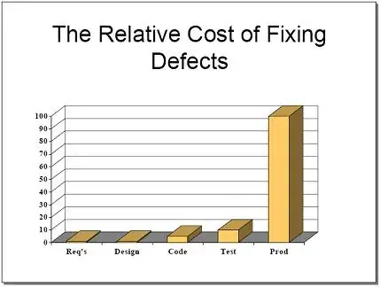

Automated testing, especially unit testing, saves money because it catches bugs early. The later a bug is found, the more expensive it is (by orders of magnitude):

  • Where's this chart from? – Aaronaught Sep 07 '11 at 23:21
    @Aaronaught: http://jonkruger.com/blog/2008/11/20/the-relative-cost-of-fixing-defects/ – Robert Harvey Sep 07 '11 at 23:23
    Huh... doesn't seem to be based on any actual data. Not that I disagree with the general idea but it'd be nice to see something a bit more material. – Aaronaught Sep 07 '11 at 23:26
  • @Aaronaught: It is from a Google image search for "Cost of Unit Testing." There are a bazillion such graphs; they all look the same. The original was probably from "The Mythical Man Month," but I don't have a copy in front of me right now to verify that. – Robert Harvey Sep 07 '11 at 23:29
  • In any case, there are plenty of good programming practices that cannot be "proven" in dollars and cents. As an organization, you have to decide whether you want to do it the professional way, or do it the schleppy way and wind up fighting fires for the remainder of the product's life-cycle. I've been in both situations, and I know which one is better. – Robert Harvey Sep 07 '11 at 23:31
  • It'd still be nice to have a source on that data which describes, for example, how measurements were taken and what metrics were used for "cost." Otherwise the chart is just pulled out of thin air and is as good as any made-up statistic. In any case, I think using it as the be-all-end-all is unwise, as the cost of fixing an issue in production varies according to what your production environment actually is, and what your customers are expecting. For the record, I am 100% for unit testing, but I don't think the chart really helps to answer the original question. – Mitch Lindgren Sep 07 '11 at 23:32
  • Barry Boehm is apparently the authority on software defects as a function of the delay in finding them. He is the inventor of the Spiral Model, and has done a number of studies on defect cost as a function of time. See http://www.google.com/url?sa=t&source=web&cd=4&ved=0CDEQFjAD&url=http%3A%2F%2Fciteseerx.ist.psu.edu%2Fviewdoc%2Fdownload%3Fdoi%3D10.1.1.103.4004%26rep%3Drep1%26type%3Dpdf&rct=j&q=Barry%20Boehm%20cost%20of%20software%20defects&ei=tgBoTr8atIqwAoDC0JAO&usg=AFQjCNGszgYGu7QzWZ8fyr3j4sHPYC2SCA&sig2=G1oU9MS3M_1yWQoGhlGP9g – Robert Harvey Sep 07 '11 at 23:40
  • @Robert Harvey You are correct - this data is from Boehm. However, I'm not sure which work of his it's in. It's not Software Engineering Economics - I looked. I loaned McConnell's Rapid Development to a process engineer at work recently, but this study and two similar ones are cited in that book - if someone has a copy handy, they could look it up and provide citations. – Thomas Owens Sep 07 '11 at 23:43
