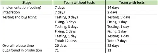

117
I agree with the rest of the answers but to answer the what is the time difference question directly.
Roy Osherove in his book The Art of Unit Testing, Second Edition page 200 did a case study of implementing similarly sized projects with similar teams (skill wise) for two different clients where one team did testing while the other one did not.
His results were like so:
Team progress and output measured with and without tests
So in the end of a project you get both less time and fewer bugs. This of course depends on how big a project is.

  • On the table, does integration refer to integration testing, deploying / integrating it with a pre-existing system, or something else? – Panzercrisis Jun 15 '16 at 15:31
  • 33
    The sample size is way too small to consider this to be scientific but I think it's representative of what lots of people experience. I find that when I do TDD, most of the extra time is spent fixing the bugs that cause my unit tests to fail, not writing the tests themselves. That's not really adding extra time, just shifting when you find and fix those issues. Any real extra time is in fixing problems that you wouldn't have found, at least not in the first go-round. – JimmyJames Jun 15 '16 at 15:38
    @Panzercrisis integration refers to pretty much gluing together all the different classes/functionality as well as external systems like network configuration etc. – Aki K Jun 15 '16 at 15:47
  • Oh, so they were using drivers to begin with? – Panzercrisis Jun 15 '16 at 16:04
  • @Panzercrisis I am not sure to be honest. It is not that clear in the book and I have read it over 2 months ago. – Aki K Jun 15 '16 at 16:15

  • What I'm curious about is a hypothetical third column that I believe should be in the table, "Team with buggy tests". I'd like to see how much of an impact on overall time the tests take if at least some of them are themselves erroneous, because that's a situation that could potentially spend the coders on wild goose chases looking for nonexistent bugs in the production code. – Justin Time - Reinstate Monica Jun 19 '16 at 19:43
    @JustinTime I believe that bad and/or buggy tests can make the matters much worse than no tests at all. Finding bugs in tests is very hard and brittle tests make code change way harder and time consuming. The author shares the same sentiment throughout the book. – Aki K Jun 20 '16 at 08:45

    @AkiK Makes sense, but it'd be interesting to see just how much worse bad tests can make things, and would help illustrate the point that tests have to be done properly to actually be of use. – Justin Time - Reinstate Monica Jun 22 '16 at 17:33
    @JustinTime I definitely agree that an illustration like that would be useful. It is fundamental for people to understand that tests and TDD are not a magic recipe that "just works" but a hard to obtain skill that is very different from implementing new features. – Aki K Jun 22 '16 at 21:18
