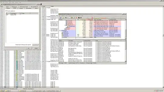

SOOOOOOOOO, my first thought was that I'm dealing with some kinda anti-debugging technique, so I tried to run the malware inside the VM and intercept some data from it -
And it seems like it's running alright and even created a UDP socket, no access violation or something like that.
