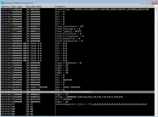

If you want to try Olly 2.01, it has a nice feature for this particular case : "Decode as structure" in the Dump Window.
Decode as structure
Decoded
