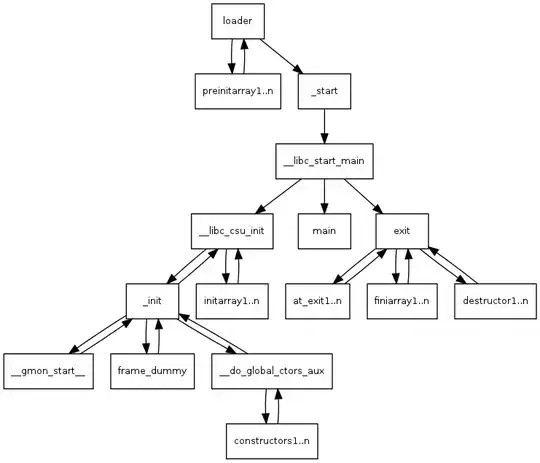

In fact, the procedure __libc_start_main() initialize the memory for a process running with the libc dynamic library. And, once done, jump to the procedure located in %rdi (which usually is the main() procedure). See the following picture to have a global view of what does the __libc_start_main() procedure [1]
ELF complete callgraph
So, indeed, the address of the main() procedure is at 0x4028c0. Let disassemble a few instructions at this address:
