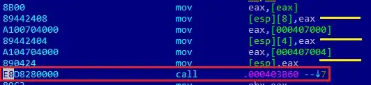

If the application is a GUI, usually there are 4 arguments that will push to the stack and a call to an address.
Example:
For console application, it has 3 arguments.
Example:
But still, it must be depend upon the compiler. I hope it help you.

    So by this, you'd look for a function that takes 3 arguments for a console application in order to find the main function? – xorist Nov 01 '18 at 17:47
    @xorist Yes, and you may observed that the main function must be located before the cexit() or ExitProcess(v1) is called.
    This is the pseudo code produced by IDA Pro.
    sub_403B20(dword_407004, dword_407000, *v0); cexit(); ExitProcess(v1);
    – ismael_akez Nov 01 '18 at 18:29

  • I do have a question, in your images where do you see the number of parameters that are being used? – xorist Nov 02 '18 at 12:30
  • @xorist By looking in the number of values pushed or moved to the stack, eg: mov [esp], xx, mov[exp+4], xx – Fabian Mendez Nov 02 '18 at 20:27
  • @FabianMendez Oooh, I see. That should've been obvious to me by the yellow marks haha – xorist Nov 05 '18 at 12:25
