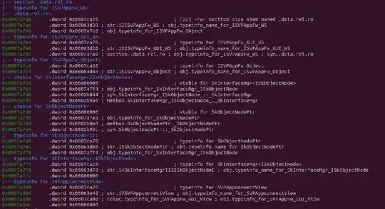

but the new file "(binary2)" I want to edit now looks a bit different.
.rodata rodata
.data.rel.ro data.rel.ro
My C# code can't work in the second ELF, because it's a bit different. Unfortunately I don't know what to do. Maybe someone has an approach for me, so I can write a new little tool.
