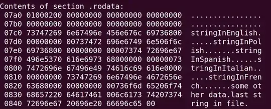

Our first step will be finding ELF section containing all strings in different languages. To do this, you may use objdump - just look at the section name, where you see these strings. In my case it is .rodata as you may see below: enter image description here Please note that we encounter additional problem here - every string in LANGUAGES_TABLE takes only 21 bytes, while stringInYourFavouriteLanguage uses 30. I'll return to it in a while.

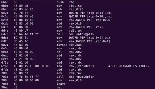

First of all, you need to find the piece of code to patch. In our example it is: enter image description here Note that 21 bytes starting from offset 0x6e8 are actually responsible for multiplying arg by 21 and loading address of LANGUAGES_TABLE to RDX. Here, lea computes this offset using RIP. What we need to do, is to determine offset we want to add to RIP to achieve LANGUAGES_TABLE_PATCHED.
And here, please keep in mind an important thing - we have to determine this offset depending on the address of this lea instruction in our patched file.
So, either we leave it at its place and change only offset (that is last 4 bytes of opcode), so that it points to our patched table, or we just write our code and then add relevant number of nops (we could then write lea as lea [rip] and then simply check the required offset with a debugger and change this to lea [rip+offset]) - that's what I did. Nevertheless, our patched code may look like this: enter image description here
It's responsible for calculating address of LANGUAGES_TABLE_PATCHED[30*arg].

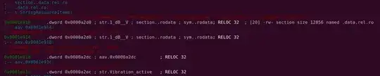

.data.rel.ro
It is the last section you want to modify. It contains pointers to the strings that were in the .rodata section before you modified them.sectionDataRelRo
So, now you need to fix all of the pointers contained here to point on the strings in the new .rodata section you have just created. Notice that each entry here is just a pointer (i.e. contains 4 bytes, so it has fixed length), so you may just patch it right away, without need to replace this section using objcopy.
