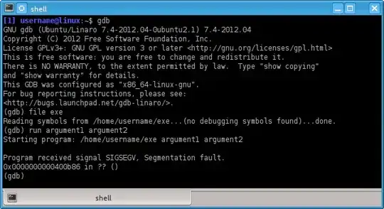

I have GDB but the binary I want to reverse engineer dynamically has no symbols. That is, when I run the file utility it shows me stripped:
ELF 64-bit LSB executable, x86-64, version 1 (SYSV), dynamically linked (uses shared libs), for GNU/Linux 2.6.18, stripped
What options do I have if the environment in which this runs doesn't allow a remote IDA Pro instance to connect to gdbserver? In short: the environment you have is limited in what it allows you to do, but you do have trusty old gdb and a binary to reverse engineer.

Since we want to dynamically analyze the binary, we need to start it first.
Command line
We can do that straight from the command line by passing not only the path to the binary, but also the arguments we want to start it with. The whole process then looks like this:
$ gdb --args ./exe argument1 argument2

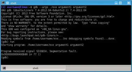

Easy enough. From the (gdb) prompt you can then issue the run command (shorthand r) to run ./exe with the parameters given on the command line. I prefer this method, but your mileage may vary.
Starting a process using the described method

Phew, but why does the program stop with a SIGSEGV (segment fault)?
Well, we don't know yet, but it looks like this little beasty wants the proper treatment. Since we practice defensive computing, we don't want to run anything we don't know much about, right? So let's start over. If this would have been malware we'd have to flush the machine and reinstall or restore a snapshot if it's a VM guest.

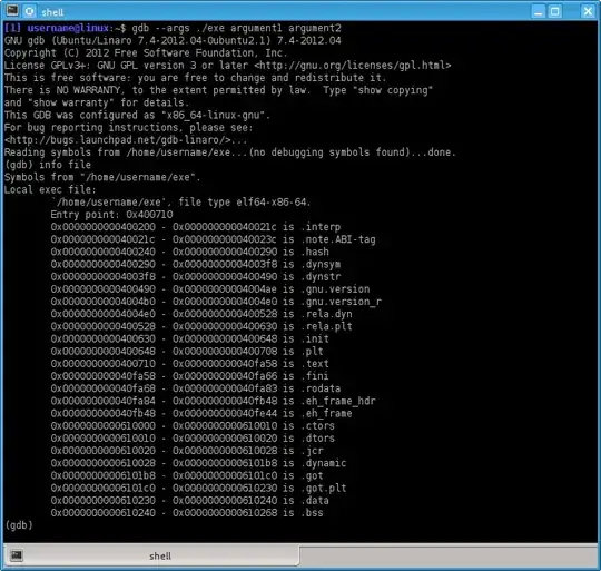

First we'll want to run the info command as follows:
(gdb) info file
Observe:
info file command in GDB
There are two important pieces of information, the most relevant for us being the line stating:
Entry point: 0x400710
alright, so we can set a break point on that one and then run the process with the arguments we fancy.

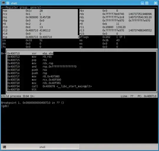

Assembly and GDB
So you're used to see the next line you're going to execute and then your trusty old (gdb) prompt. But no such thing. We have no source for this binary and furthermore symbols. Doh! So we contemplate the blinking caret at the (gdb) prompt and wonder what to do. Don't fret, GDB can also handle assembly code. Only problem, it defaults to the - in my opinion - inconvenient AT&T assembly syntax. I prefer the Intel flavor and the following command tells GDB to do just that:
(gdb) set disassembly-flavor intel
Showings the assembly code
And how is it going to show us the assembly code? Well, similar to the TUI mode (check the tag wiki for ) by using the following command:
(gdb) layout asm
and if you are so inclined, also:
(gdb) layout regs
which will also show you the contents of the registers in an overview.
Let's run it again
So we end up with the following .gdbinit for our purposes:
file exe
break *0x400710
layout asm
layout regs
run argument1 argument2
And when we start gdb without arguments we end up with this:
GDB with asm and regs layout
Sweet. So we can see the disassembly while we step through the code. We could conclude this here, but of course there are more tricks to be learned, so why not go a little further.
NOTE: the registers with white/gray background show that a value has changed. Not too meaningful when we just started the program, but mighty useful when stepping through code later on.
