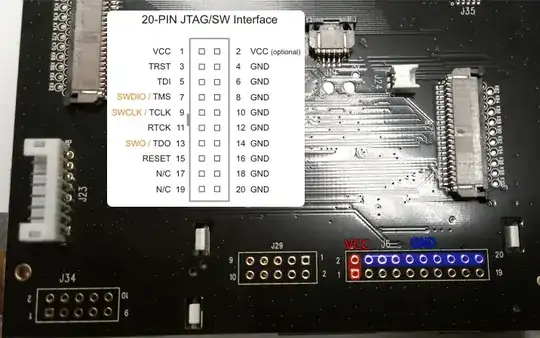

I created a video how I identified a possible JTAG connection with a multimeter. Here is a picture showing which pins are connected and it matches with a standard JTAG pinout for VCC and GND. This is an indication that it could be JTAG, though it doesn't have to be.
example JTAG connector
samuirai
