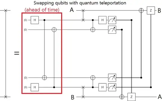

Near the end of the post there is this circuit graphic
swapping qubits with quantum teleportation (ahead of time) & it is also stated:
I would go into detail about how this works, but honestly it's just two quantum teleportations shoved together and this post is already way too long.
Can someone provide more detail on just two quantum teleportations?

The simplest way to generalize teleportation is to just repeat it. If you have one EPR pair divided between Alice and Bob, teleportation allows you to move one qubit from Alice to Bob (or vice versa) by consuming the EPR pair and using a classical communication channel. If you have two EPR pairs, you can move two qubits by performing two independent teleportations. If you have N EPR pairs, you can move N qubits by performing teleportation N times.
In the case of the diagram you posted, what's happening is that there is one teleportation from Alice to Bob (to move the A qubit from the top to the bottom) and one teleportation from Bob to Alice (to move the B qubit to the top). This is somewhat obscured by the fact that the teleportations' operations are being interleaved, and also the two swap gates that ensure the output qubits end on on the same lines as the input qubits. But it really is just two independent copies of the teleportation circuit, one from Alice to Bob followed by one from Bob to Alice, but "shoved together" (i.e. with the operations slid around so they interleave more).

You can think of teleportation as the process of sending the state of one qubit from one place to another without having to physically send the qubit itself. Instead, you start with an entangled pair shared between the two locations, and that entanglement is consumed in the process. If you're not already familiar with teleportation, I strongly recommend that you find out about it. It's one of the basic building blocks of many results in quantum information.
Of course, a swap gate is simply sending the state of one qubit from A to B, and another from B to A, which you can therefore do with two teleportations. So, how does this circuit work? Consider two locations, A and B. At each location, there are 3 qubits. So, at A, we have A1, A2 and A3.
  • Before the start of the main protocol, we create two entangled pairs, one between A2 and B3, and another between B2 and A3. This is the stuff in the red box.
  • For the main protocol, there is a one-qubit state (unknown) on A1, and another on B1. The aim is to swap them.
  • The A1 qubit is teleported using the A2-B3 entangled pair, so the state arrives at B3.
  • The B1 qubit is teleported using the B2-A3 entangled pair, so the state arrives at A3.
  • A swap is performed from A3 to A1, and another from B3 to B1. Hence, the transmitted states arrive on the specific qubits they were supposed to be on.
You can't quite follow that sequence on the depicted circuit diagram as the final swaps are actually performed a little bit earlier. That just changes which qubits some of the operations are performed on.
Hopefully, you can see that this really is just 2 teleportations run independently to distribute the 2 different quantum states. As such, you can easily generalise it. If you have n parties, and everybody knows in advance where they will be sending their qubit, then, again, each party can manage with just 3 qubits, and they will share two entangled pairs, one with the user they'll be receiving a state from, and one with the user they'll be sending their state to.
