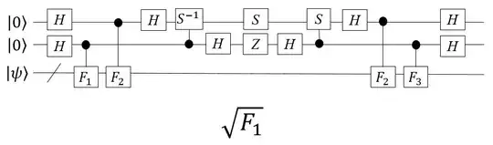

We know that the order of each of the quarter-turn moves is four, and we can use this to construct circuits for the square-root of a quarter-turn move.
Square Root of F1
Indeed, following the recipe outlined in this question, we can prepare circuits for the roots of each generator; $\sqrt{F_1}$ is an example as above. This uses $9+6+6+9=30$ controlled-SWAP (CSWAP) gates with $H$ and $S$ gates for the quantum phase estimation. The two reusable ancillae store the phases of the eigenspace, while $\vert\psi\rangle$ is a register of $24$ six-dimensional qudits (or $24\times 3=72$ qubits).
