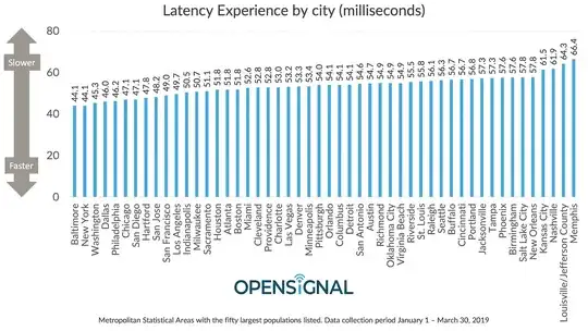

An article on the website Fierce Wireless: "3G/4G wireless network latency: How do Verizon, AT&T, Sprint and T-Mobile compare?" has a chart derived from information obtained from the OpenSignal website, their article: "State of Mobile USA: Quantifying the bar for 5G to beat" which offers much more recent data:
Latency by Carrier
Different cities have different carriers and different equipment, with a difference in latency of 50%.
