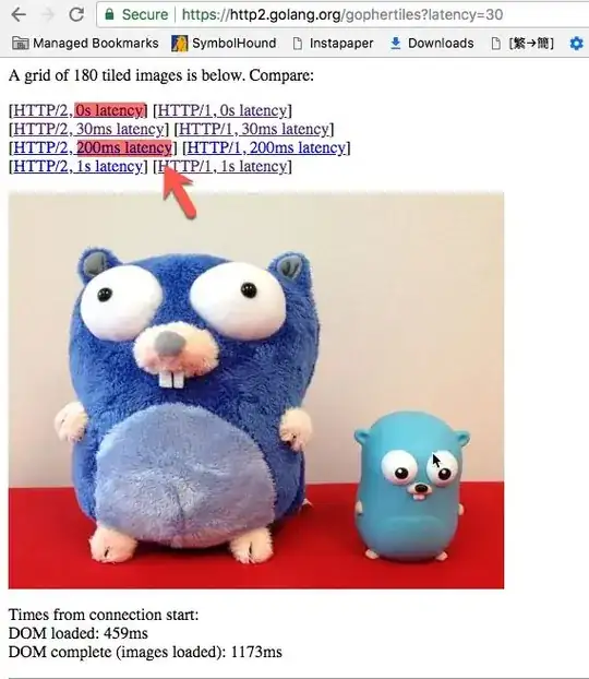

Golang community provide a HTTP/2 demo website to compare the performance between HTTP 1.1 and HTTP/2.
We can choose different latency, e.g. 0s latency, 30 ms latency, 200ms latency.
  1. Is latency a terminology of computer science?
  2. What does that mean?
  3. What's the difference between latency and Round Trip Time?

In your case "latency" means an artificial delay within the HTTP server that gets added on top of the already present delays. So, if you've got an effective round-trip time of 50 ms to the server and select "200 ms latency" you can expect a reply to a request within 250 ms (plus the processing overhead on the server).

Even with non-interactive cases, latency can have an effect (which is illustrated in the OP's example): when there are lots of small files to download, latency can result in a higher total load time if the protocol has to wait for one file to be completely downloaded before starting the download of the next one, compared to a protocol which would allow multiple requests to be sent at once, and the responses being sent with no interruption between successive files.
