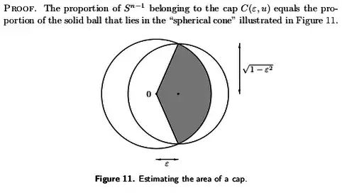

Here's an excerpt from Lecture 2 of Keith Ball's An Elementary Introduction to Modern Convex Geometry:
excerpt
See the link for details, but as the image shows, the measure of a spherical cap cut off by a hyperplane which is $\varepsilon$ away from the origin is bounded above by the ratio between volume of a ball of radius $\sqrt{1-\varepsilon^2}$ and the volume of a ball of radius 1, that is, $(1-\varepsilon^2)^{n/2}$. So if $X$ and $Y$ are independent random unit vectors (uniform on the sphere), then the portion of the cap area is $$ P(\langle X,Y\rangle > \varepsilon) \le (1-\varepsilon^2)^{n/2} \le e^{-n\varepsilon^2/2} $$ which is close to $1$ when $n$ is large (if $\varepsilon$ is fixed, at least).
