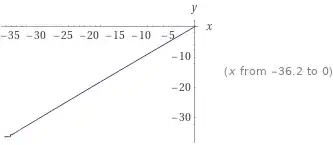

Here is a plot of $$\text{Ei}\left(-\lim_{a\to0}Q^{-1}\left(a,-\frac y{\Gamma(a)}\right)\right):$$
Plot of $$-\lim_{a\to0}Q^{-1}\left(a,-\frac y{\Gamma(a)}\right): $$
so $$\text{Ei}\left(-\lim\limits_{a\to0}Q^{-1}\left(a,-\frac y{\Gamma(a)}\right)\right)=x\le0$$

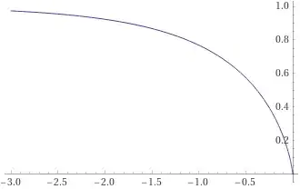

Here is a plot of $\text {li}\left(e^{-\lim\limits_{a\to0}Q^{-1}\left(a,-\frac x{\Gamma(a)}\right)} \right)=x$:
Plot of $$e^{-\lim\limits_{a\to0}Q^{-1}\left(a,-\frac x{\Gamma(a)}\right)}: $$
again which only works for $0\le y\le1$

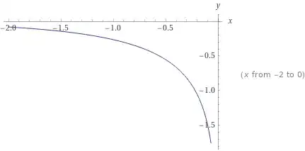

Here is a demo
and
$$\boxed{x=\text{li}(0\le y<1)\implies y=\text {li}^{-1}(x<0)=e^{-\lim\limits_{a\to0}Q^{-1}(a,-ax)}}$$
Here is a demo
where the limit is not $0$ and the series seems to have no effect on the domain of the function. The correct decimal places that the formula gives is based on the precision of $a$. These inverse functions relate to the quantile of a gamma type distribution with a limit.
