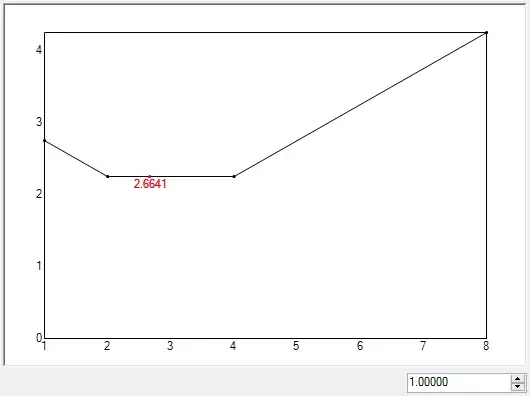

Let's take a step back. Forget you ever learned about the arithmetic mean.
Let's say you have a list of numbers. A natural question is: what is the center of this list?
To answer that, you have to ask yourself: what is a "center" in the first place?
Why, for example, is 9 not the center of the numbers {1, 2, 4, 8}?
If you think about it for a while, you will realize that the center of a list of numbers it the number $\bar x$ whose total distance from the all the numbers $x_k$ in the list is minimum.
So that means you want to minimize $\sum_k \lVert x_k - \bar x \rVert$.
But how do you define $\lVert x \rVert$? A natural definition is $|x|$.
When you define it like that, you get $\bar x = $ the median. Why? Try a simple example on a piece of paper to see it visually -- the left and right side penalties cancel at the median:
Also notice that when there are an even number of elements, any element in the interval that holds the two middle elements is "a median". However, by taking an upper limit, you can find a single value rather than an interval -- which in this case is 8/3.

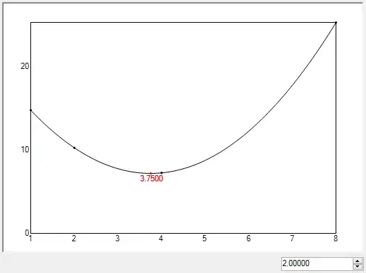

But you can also define $\lVert x \rVert =|x|^2$. In that case, you get $\bar x = $ the arithmetic mean:
Why is this the arithmetic mean? The formula for this should explain:
If you have $\bar x = \arg \min_x \sum_k |x_k - x|^2$, then you can set its derivative to zero:
$$\frac{d}{d\bar x}\sum_k |x_k - \bar x|^2 = 0$$ $$\sum_k 2 (x_k - \bar x) = 0$$ $$\sum_{k=1}^n x_k = n \bar x$$ $$\bar x = \frac{1}{n} \sum_{k=1}^n x_k$$
Notice this is exactly the arithmetic mean?

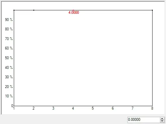

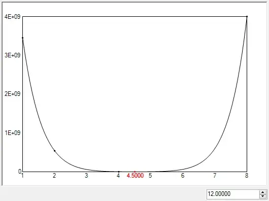

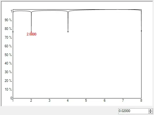

Now what if we go further? We've tried $\lVert x \rVert = |x|^1$ (the median) and $\lVert x \rVert = |x|^2$ (the mean).
What if we try $\lVert x \rVert = |x|^0$? If we do, we get back the mode, assuming we define $0^0$ to be $0$ (we have to take a limit here to see what happens):
What if we try $\lVert x \rVert = |x|^\infty$? In this case we get back the midpoint -- that is, the average of the minimum and the maximum values (again, we have to take a limit to see what happens):

    @IbrahimNajjar: Great questions, sure thing. In the first diagram, I'm plotting y = $\sum_{k=1}^4,\frac{1}{4}|x_k - x|^d$ for $d = 1$ and different values of $x$, where $x_k \in {1, 2, 4, 8}$. Thus at $x = 3$ we have $y(3) = (2 + 1 + 1 + 5)/4 = 2.25$. You would get the same shape if you take out the $1/4$ factor, just scaled up. (Sorry it's confusing though - I should've mentioned the scaling.) I'm taking $\lim_{d \to 1^+}$. Regarding the closed-form equation for the median, it's quite non-obvious, but very elegant; see here. – user541686 Apr 04 '22 at 20:55

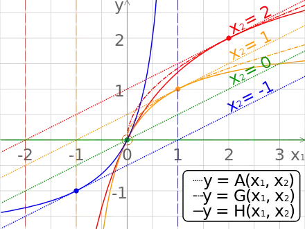

Graph of the Arithmetic, Geometric and Harmonic Means
AMGMHM
The Arithmetic and Geometric Mean within a Semi Circle
AMGM
