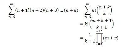

Wolfram Alpha is able to telescope sums of the form $\sum (n+1)\cdots(n+k)$
e.g. $(1\cdot2\cdot3) + (2\cdot3\cdot4) + \cdots + n(n+1)(n+2)$
How does it do it?
EDIT: We can rewrite as: $\sum {(n+k)! \over n!} = \sum k!{(n+k)!\over n!k!} = \sum k!{{n+k} \choose n}$ (Thanks Daniel Fischer)
EDIT2: We can also multiply out and split sums. So e.g.
$$\sum (n-1)n(n+1) = \sum (n^3-n) = \sum n^3 - \sum n$$
But sums of powers actually seem to be more nasty than the original question, involving Bernoulli numbers. (Thanks Claude Leibovici)
And is there any name for this particular corner of maths? (i.e. How might I go about searching the Internet for information regarding this?)

Hint: $$ \sum_{n=k}^m\binom{n}{k}=\binom{m+1}{k+1} $$ A generalization is discussed in this answer. The equation above is equation $(1)$ with $m=0$.
Telescoping sum
To turn the sum in the question into a "telescoping sum", we can use the recurrence for Pascal's Triangle: $$ \binom{n+1}{k+1}=\binom{n}{k}+\binom{n}{k+1} $$ Using this recurrence, we get $$ \begin{align} \sum_{n=k}^m\binom{n}{k} &=\sum_{n=k}^m\left[\binom{n+1}{k+1}-\binom{n}{k+1}\right]\\ &=\sum_{n=k+1}^{m+1}\binom{n}{k+1}-\sum_{n=k}^m\binom{n}{k+1}\\ &=\left[\binom{m+1}{k+1}+\color{#C00000}{\sum_{n=k+1}^m\binom{n}{k+1}}\right]-\left[\binom{k}{k+1}+\color{#C00000}{\sum_{n=k+1}^m\binom{n}{k+1}}\right]\\ &=\binom{m+1}{k+1}-\binom{k}{k+1}\\ &=\binom{m+1}{k+1} \end{align} $$ The sums in red are the terms that are telescoped out, leaving just the first and last terms. In this case, the last term $\binom{k}{k+1}=0$.
robjohn
  • 345,667
Let $$p_n=\prod_{r=1}^k (n+r)=\overbrace{(n+1)(n+2)\cdots(n+k)}^{k \ \text{terms}}$$ which is the product of $k$ consecutive integers.
Consider the difference of two consecutive terms, where each term is the product of $k+1$ consecutive integers, i.e. $$\begin{align} &\prod_{r=1}^{k+1}(n+r)-\prod_{r=0}^k(n+r)\\ &=\overbrace{\underbrace{(n+1)(n+2)\cdots(n+k)}_{p_n}(n+k+1)}^{(k+1) \ \text{terms}}-\overbrace{n\underbrace{(n+1)(n+2)\cdots(n+k)}_{p_n}}^{(k+1) \ \text{terms}}\\ &=p_n[(n+k+1)-n]\\ &=p_n(1+k) \end{align}$$
Hence, $$p_n=\prod_{r=1}^k (n+r)=\frac1{1+k}\left[\prod_{r=1}^{k+1} (n+r)-\prod_{r=0}^k (n+r) \right]$$ which is convenient for telescoping.
Required summation, $$\begin{align} S=\sum_{n=0}^{m}p_n&=\sum_{n=0}^{m} \prod_{r=1}^{k} (n+r)=\sum_{n=0}^{m}(n+1)(n+2)(n+3)\cdots (n+k)\\ &=\frac1{k+1}\sum_{n=0}^{m} \left[ \prod_{r=1}^{k+1} (n+r)-\prod_{r=0}^{k} (n+r)\right]\\ &=\frac1{k+1}\prod_{r=1}^{k+1} (m+r) \qquad \blacksquare\end{align}$$ by telescoping.
In your example, $k=3$, hence the general term is
$$(n+1)(n+2)(n+3)=\frac14\left[(n+1)(n+2)(n+3)(n+4)-n(n+1)(n+2)(n+3)\right]$$
Hence, by telescoping from $n=0$ to $m$, $$\begin{align}S&=1\cdot2\cdot3+2\cdot3 \cdot 4+\cdots +(m+1)(m+2)(m+3)\\ &=\frac14(m+1)(m+2)(m+3)(m+4) \end{align}$$
NB: It is interesting to note that this result bears a striking resemblance to integration.
Compare the standard integral $$\int_0^m n^k dn=\frac{m^{k+1}}{k+1}$$ to the result of the summation above, which can also be stated as $$\sum_{n=0}^{m}n^{[k]}=\frac {m^{[k+1]}}{k+1}$$ where $n^{[k]}$ is my adjusted* Pochhammer symbol for rising factorials, defined as $$n^{[k]}=\prod_{r=1}^{k}(n+r)=(n+1)(n+2)(n+3)\cdots(n+k)$$
The actual Pochhammer symbol for rising factorials, $n^{(k)}$, starts from $n$ itself and not $n+1$, i.e. $$n^{(k)}=\prod_{r=1}^{k}(n+r-1)=n(n+1)(n+2)\cdots(n+k-1)$$

For completeness, a solution using the combinatorial/binomial approach, as initiated by RobJohn:
Let $p(n, k) =n(n+1)...(n+k-1) =\prod_{j=0}^{k-1} (n+j) $.
Then (writing each step in detail)
$\begin{array}\\ p(n+1, k)-p(n, k) &=\prod_{j=0}^{k-1} (n+1+j)-\prod_{j=0}^{k-1} (n+j)\\ &=\prod_{j=1}^{k} (n+j)-\prod_{j=0}^{k-1} (n+j)\\ &=(n+k)\prod_{j=1}^{k-1} (n+j)-n\prod_{j=1}^{k-1} (n+j)\\ &=((n+k)-n)\prod_{j=1}^{k-1} (n+j)\\ &=k\prod_{j=1}^{k-1} (n+j)\\ &=k\prod_{j=0}^{k-2} (n+1+j)\\ &=kp(n+1, k-1)\\ \end{array} $
or, putting $k+1$ for $k$ and $n$ for $n+1$, $p(n, k) =\frac{p(n, k+1)-p(n-1. k+1)}{k+1} $.
Therefore
$\begin{array}\\ \sum_{n=1}^M p(n, k) &=\sum_{n=1}^M \frac{p(n, k+1)-p(n-1. k-1)}{k+1}\\ &=\frac1{k+1}\sum_{n=1}^M (p(n, k+1)-p(n-1. k+1))\\ &=\frac1{k+1}(p(M, k+1)-p(0, k+1))\\ &=\frac{p(M, k+1)}{k+1}\\ \end{array} $

$$ \color{#66f}{\large\sum_{n = 0}^{m}\pars{n + 1}\ldots\pars{n + k} =k!\,{k + m + 1 \choose m}} $$
