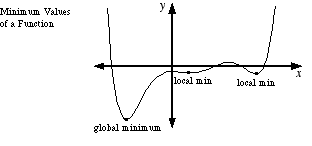

Consider a real function $f$, and suppose it has a local minimum at $a\in \mathbb R$.
It typically looks like
What hypotheses can be added to $f$ so that there is some $\epsilon >0$ such that $f$ is convex over $(a-\epsilon,a+\epsilon)$ ?
The motivation for this question is intuition, but I can't find any valid criterion.
