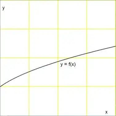

BONUS. But the "closed form" phrase keeps ringing in everyone's head ..
As suggested in a comment by Semiclassical, making a graph of the following more general function $f(x)$ might be interesting. $$ f(x) = \lim_{n\to \infty}\sqrt[2]{x+\sqrt[3]{x+\sqrt[4]{x+\cdots+\sqrt[n]{x}}}} $$ Because, if the graph of that function could be recognized as belonging to some "elementary" function, say $g(x)$, then we could say that the outcome of the OP's question is simply $g(2)$ .
So here goes, for $\;0 < x < 4\;$ and $\;0 < y < 4\;$ :
It is conjectured that $f(0) = 0$ and that there is a singularity ( jump $0\to 1$ ) at that place.
Han de Bruijn
  • 17,070
  • I think a closed form is pretty hopeless myself. But what I'd be curious to see is to see a plot of $C$ when 2 is changed to a range of different values (say, 1 to 3). – Semiclassical Jul 25 '14 at 19:27
  • @Semiclassical: If you would formulate that as a question at MSE, then maybe someone would think of trying to answer that question. Please notify me if you do :-) – Han de Bruijn Jul 25 '14 at 19:58
  • Fair enough! I may do that in a bit. – Semiclassical Jul 25 '14 at 20:00
    @Semiclassical: Couldn't resist. Please take a look at the BONUS part. – Han de Bruijn Jul 27 '14 at 11:52
  • That's great! Though I don't think you need to 'conjecture' that $f(0)=0$: the backwards recursion in that case is just $a_{n=1}=\sqrt[n]{a_n}$. so any positive seed would become arbitrarily close to zero as $n\to\infty$. – Semiclassical Jul 27 '14 at 19:29
  • @Semiclassical: Close to zero ? I'd rather think close to one as $n \to \infty$ . – Han de Bruijn Jul 28 '14 at 09:49
  • Not a closed form yet: $g(x) \not \equiv 1 + \ln(1+x)$ . – Han de Bruijn Jul 28 '14 at 09:50
  • You're right, I was being too careless. One evidently has to take the limit very carefully. (Presumably the computation 'implements' that limit in a different way than $x^{1/n}\to 1$ as $n\to \infty$ for $x\gtrsim 0$.) – Semiclassical Jul 28 '14 at 14:17
    I guess it's some kind of singular perturbation near 0? I suppose it somehow reflects the fact that the order of limits ($x_0\to 0$ or $n\to \infty$) matters a lot. (In the computation, it's definitely the latter; I'd think that the $f(x)\to1$ limit reflects the former.) – Semiclassical Jul 28 '14 at 19:21
  • The computation is straightforward and uses no tricks. That even for very small positive values of $x$ that function $f(x)$ converges so fast to $1$ came for me too as a surprise. We know for sure that for $x=0$ the value of $f(x)$ must be exactly zero, while $\lim_{x\to 0} f(x) = 1 \ne f(0) $ . Right ? – Han de Bruijn Jul 28 '14 at 19:25
  • @Semiclassical: I think your last comment is quite to the point. Thanks. – Han de Bruijn Jul 28 '14 at 19:28
