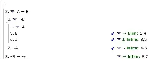

I have been stuck on this proof for a while. Here's where I'm at:
Goal $(\neg B \to \neg A) \leftrightarrow (A \to B)$
l 1. $A \to B$
ll 2. $\neg B$
lll 3. $A$
lll 4. $B$ Elim 1,3
lll 5. $\neg B$ Reit
ll 6. $A \to \neg B$ Into 3-5
ll 7. $\neg A$ ????
l $\neg B \to \neg A$ Into 2-7
If someone can help it will be great. Thank you

I don't get where you're going from step 6, but note the following.
In 4. you got $B$ and in the same subproof you got $\neg B$. You can infer a contradiction and proceed with $\neg$-$\text{Intro}$.
The other subproof should be similar.
Edit: See what I mean below.

  • I am sorry but I am not quite sure what u mean. Can u please explain? Thank you – user3727903 Jun 11 '14 at 00:01
  • @user3727903 Don't apologize. See the edit. – Git Gud Jun 11 '14 at 00:19
  • lol that was so helpful. thank you but any suggestions on connecting both sentences or that's how I would end the proof? I am still new at this. thanks again – user3727903 Jun 11 '14 at 00:28
  • @user3727903 From where I left off you should start a new subproof with premise $\neg B\to \neg A$ and infer $A\to B$. When you have both subproofs, you can use $\leftrightarrow$-$\text{Intro}$ on them to conclude. – Git Gud Jun 11 '14 at 00:31
    @user3727903 In case it wasn't clear, the new subproof I mention should be at the same level as the one I did, not inside it. – Git Gud Jun 11 '14 at 00:37
  • Thank You very much for your help. I was able to correctly answer the proof. Would it be possible to e-mail you about other proofs that I am having trouble with? – user3727903 Jun 11 '14 at 01:01
