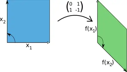

If you consider a matrix $$\begin{pmatrix} a&b\\c&d \end{pmatrix} $$ the determinant is given by $ad-bc$. You may wonder what information does $ad-bc$ may have within itself. All you need to do is to view things in geometric manner when you are unable to visualize things in algebraic way. Matrices are closely related to fields: in vectors and linear algebra, we representing vectors in terms of matrices. They can be seen as collections of vectors. The example that I have in mind is: consider a billiard table. Before hitting the balls, you take a thing which has a triangular frame and then arrange all the balls (present in an irregular manner) into a triangular shape. It's like arranging things in an organised manner, as human beings always try to do.
Let me explain the topic in greater detail. Area
If you look at the above figure, you can clearly see the coordinates. You can think of the columns of the matrix as vectors and the entities in the column representing their Cartesian placement (the coordinate positions). So now if you take all the above things into consideration, you can clearly see that if $ad-bc=0$ then the rhombus suddenly became a straight line, and in generalized manner a parallelopiped suffers a decrement in dimension by one (making the volume zero, which indirectly implies that it has an area). So analogously one can see that if the determinant becomes zero, according to the Cramer's rule, it makes the denominator go $\infty$, which is a violation.
Some of the important alternative notions about determinants: (stress on second one)
  • Determinants in reality can be thought as a measure of multiplicative change in the volume of parallelopiped when it is subjected to linear transformation. It can be shown as :
  • And the main notion that answers the connection between the determinant and existence of solutions is that the determinant of a matrix is zero if and only if the column vectors of the matrix are linearly dependent. Thus, determinants can be used to characterize linearly dependent vectors. For example, given two vectors $v_1, v_2$ in $R^3$, a third vector $v_3$ lies in the plane spanned by the former two vectors exactly if the determinant of the $3$-by-$3$ matrix consisting of the three vectors is zero. So one needs to take the theory of multilinear forms into consideration. I can't express the entire theory, but to give you a short notion, the determinant is actually a multi-linear form in general. So in a deep sense it measures the manifestations of the things related to vectors.
  • And when determinants are negative, they have a role of orientation in geometric sense, which is another crucial point.
