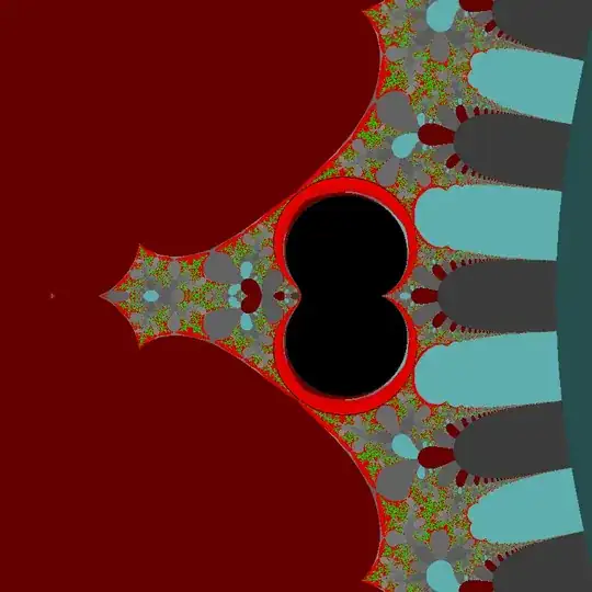

Surely there are no other fixpoints in that area. However, one should observe the difference between divergence and convergence-to-cyclic-points . In the left side (negative real part) I was surprised that we have mostly convergence-to-cyclic-points , while divergence (of absolute values) was only observed in the right side (positive real part) - which I think is a better characterization of the properties presented in the question.
A relatively raw attempt to (compute and) illustrate the cycle-lengthes of sets of attracting cyclic points gives the following picture (coordinates $-5..+5, -5i..+5i$) .
In the middle we see that black nephroid - this is the region where the complex numbers with definition $z_0=z $ and then $ z_{k+1}=z^{z_k}$ iterate to the fixpoints (cycle-lengthes 1), known as "Shell-Thron-region".
But also mainly on the left side (negative real part) the complex bases $z$ have attracting cyclic points, most of cyclelength $3$ - the dark red color. Attracting cyclic points with higher cyclelenghtes got lighter red color.
(Mainly) on the rights side (positive real part of $z$) it seems that we have the "point at infinity" as fixpoint - the iterations diverge quickly or less quick; the fastest diverging bases are at the right side, the dark teal color. The lighter teal/blue colors indicate bases which diverge slower.
As I wrote above, this is based on a somehow crude procedure - the characteristics of the divergent bases are not yet well analyzed due to the exorbitant values which occur- sometimes alternating with extremely small absolutes values; those are all the blue and green and reaining grey colored points.
