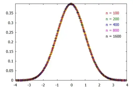

Let $\sigma_{n} = \sqrt{\mathbf{Var}_n}$ and $P_n(k) = \mathbf{Prob}[ N_n = k ]$ be the probability that $N_n$ equal to a particular value $k$. At the end is a picture comparing $P_n(k)$ versus a normal distribution for various $n$.
  • The $x$ axis is $\displaystyle\;x = \frac{k - \overline{N}_n}{\sigma_n}$.
  • The $y$ axis is the scaled probability $\sigma_n P_n(k)$.
  • The $\color{orange}{\verb/orange/}$ curve is the PDF $\displaystyle\;\rho(x) = \frac{e^{-x^2/2}}{\sqrt{2\pi}}$ for a normal distribution of unit variance.
As one can see, for all the cases tested, the scaled probability $P_n(k)$ nearly fall right on top of $\rho(x)$. To measure how close the computed probability differ from the PDF of a normal distribution. Let us define following quantity
$$\Delta_n(s) = \max\left\{ \left|\frac{\sigma_nP_n(k)}{\rho(x)} - 1\right| : |x| < s \right\}$$ This measures the biggest difference between the ratio $\frac{\text{scaled probability}}{\text{reference PDF}}$ and $1$ for $x$ within $s$ standard derivation. As shown in last column of table above. As long as we are within 2 standard derivation, the difference between the ratio and $1$ is at most a few percents and improves as $n$ increases.
