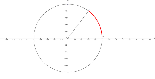

Define the unit circle to be the locus $x^2+y^2=1$.
Define $(\cos \theta,\sin \theta)$ to be the point at arc-length $\theta$ from the point $(1,0)$ on the unit circle (measuring counter-clockwise). Circle
So the red segment has length $\theta$ units.
Then we define $(\cos\theta,\sin\theta)$ to be the x- and y-coordinates of the point $D$. Since $D$ is on the unit circle, it immediately follows that $x^2+y^2=\cos^2\theta+\sin^2\theta=1$. It can also be shown geometrically that $$\sin(a+b)=\sin a\cos b+\sin b\cos a$$ From this all other standard identities can be easily derived, and the derivatives of $\sin x$ and $\cos x$ may be proved.
Note: the number $\pi$ can be defined as half the circumference of the unit circle. Then an angle of $2\pi$ radians goes around the whole circle exactly once. From the derivatives mentioned above and this definition of $\pi$ (which implies that $\sin^{-1}(1)=\pi/2$, among other things) we can use some rules of integration to show that $$\text{area of unit circle}=2\int_{-1}^1{\sqrt{1-x^2}\,\mathrm{d}x}=\pi$$
