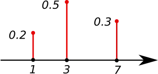

I first understood Lebesgue as integral over range rather than integral over domain but it never seemed plausible to me that it can resolve the problem of discontinuity. I think that the trick is that measure is something that better "width" of the area (function value is the same) than Rieman's $\Delta x \rightarrow 0$ does. The Lebegue is basically
$$\int_S f(s)d\mu = \sum {f(s) \mu(s)}$$
You may think that you scan over f(s) -- all the values that you may have in the domain $S = \cup(s)$ -- and sum up all rectangles of size $height(s) \times width(s) = f(s) \mu(s)$.
You can say that you integrate over range of values f(s). However, you see also other differences. Whereas Riemann implies that the width of every interval is the same dx, that is, if you have function
$$f(1) => 1\\ f(2) => 1\\ f(3) => 2\\ f(4) => 1$$
the integral will accumulate the sum as 0+1+1+2+1. So, if you have 4 coins, you can compute the sum by simply iterating them. You see that the speed of growth is proportional only to the coin value f(x) and not to the coin index, x. This is not the case of Lebesgue. For Lebesgue, you group the coins by values (I am here from Scala), List(1,1,2,1) => Occurrences(1->3, 2->1), and you see immediately that you have two heaps of coins: ones in the first heap and doubles in the second. These are two rectangles (coin value x heap size) that you need to add together. So, you integrate by range here but you not simply add together the measures (the amount of coins) that exceed current value, you add coin value x count. This is different from Riemann. This is my second stage of understanding the integrals.
This enables integrating point-charge like discontinuities. Consider a step function. It jumps instantly at some points. It is an integral of some infinitely narrow spikes and integral grows instantly at the spike point, as if there is a finite finite amount of charge/mass concentrated in infinitesimal point of space, in contrast to continously distributed charge/mass in space. The amount of that charge in the point determines the height of the step. It seems that Riemann has difficulty with integrating the spike because regardless how infinitecimal you make your dx, they fail to break the infinitesimal interval into rectangles of constant (and infinite) height f(x) to sum them up. On the other hand, we can say that there is charge n at $x=x_0$ and when we integrate over axis of values, we suddenly pass through the value n, which is measured (countable measure) to have width of k (coins), regardless it is confined in a single real point of width 0.
Now, how is this related to expectations? Your 4 coins, 3*1 + 1*2 add up to 5 euros and, when you draw arbitrary coin, you expect its value to be 3*1+2*1/4 = 5/4 = 1.25 euros. That is, one coin contributes 1.25 euro in average. The Lebesgue integral is equal to expectation when the measure of all coins (amount of coins) is one. That is, every of n coins is not actually a coin but $1/n$th of it. Now, Lebesgue integral is 3/4*1 + 1/4*2 = 5/4 is the expectation. That is not surprising because integrating every value times its probability is what the expectation is.
