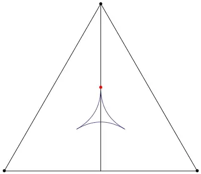

The lines which bisect the area of a triangle form an envelope as shown in this picture
alt text
It is not difficult to show that the ratio of the area of the red deltoid to the area of the triangle is $$\frac{3}{4} \log_e(2) - \frac{1}{2} \approx 0.01986.$$
But this is also $$\sum_{n=1}^{\infty}\frac{1}{(4n-1)(4n)(4n+1)}.$$
Is there any connection between the series and the deltoid? Or is it just a coincidence?

  • Uhm, "it's not difficult to show" .. I feel a bit embarrassed not being able to show anything. What's so easy about it? Can you give me a hint or a reference? – Han de Bruijn Apr 08 '14 at 12:26
    @Han de Bruijn: You can use affine transformations to show the ratio is invariant. Suppose the corners of the triangle are $(0,0)$, $(0,1)$, $(1,0)$ so the reflection of this diagram. Then green area bisectors which do not cross the base are of the form $y=c+x(2(1-c)^2-1)$ for $0 \lt c \lt \frac12$ and the lower red envelope is of the form $y=1-x-\dfrac{1}{8x}$ between $(\frac14,\frac14)$ and $(\frac12,\frac14)$. You can then find the area ratio by integration as $\displaystyle 6\left(\frac{7}{96}-\int_{1/4}^{1/2}\left(1-x-\dfrac{1}{8x}\right)dx\right).$ – Henry Apr 08 '14 at 14:18

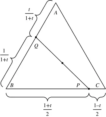

Since $|\triangle BPQ|=\frac12\sin(B)|\overline{BP}||\overline{BQ}|$, to maintain $|\triangle BPQ|=\frac12|\triangle ABC|$, we need $|\overline{BP}||\overline{BQ}|=\tfrac12|\overline{BC}||\overline{BA}|$.
$\hspace{3.4cm}$enter image description here
In the diagram above, the endpoints of the lines are parametrized by $$ P_t=\frac{1-t}2B+\frac{1+t}2C\tag{1} $$ and $$ Q_t=\frac{t}{1+t}B+\frac1{1+t}A\tag{2} $$ for $t\in[0,1]$.
The points on each line are parametrized by $$ R_t(s)=(1-s)P_t+sQ_t\tag{3} $$ To find a point on the envelope of the family of lines parametrized by $t$ we need to find where $$ \frac{\partial}{\partial t}R_t(s)=\frac{1-s}2(C-B)+\frac{s}{(1+t)^2}(B-A)\tag{4} $$ is parallel to $$ \frac{\partial}{\partial s}R_t(s)=\frac1{1+t}(A-B)+\frac{1+t}2(B-C)\tag{5} $$ Setting the cross product to $0$, we get that $$ \frac{1-s}{2(1+t)}-\frac{s}{2(1+t)}=0\tag{6} $$ which happens when $s=\frac12$. That is, the locus of the envelope is the midpoints of the line segments $$ M_t=B+\frac{1+t}4(C-B)+\frac1{2(1+t)}(A-B)\tag{7} $$ $\hspace{3.4cm}$enter image description here
Subtracting the center of the triangle (and of the deltoid) at $M_\triangle=\frac13(A+B+C)$ yields $$ M_t-M_\triangle=\left(\frac{1+t}4-\frac13\right)(C-B)+\left(\frac1{2(1+t)}-\frac13\right)(A-B)\tag{8} $$ Thus, $3$ times the area of $\frac13$ of the deltoid is $$ \begin{align} &\frac32\int_0^1(M_t-M_\triangle)\times(M_t-M_\triangle)'\,\mathrm{d}t\\ &=3|\triangle ABC|\int_0^1\left[\frac14\left(\frac1{2(1+t)}-\frac13\right)+\frac1{2(1+t)^2}\left(\frac{1+t}4-\frac13\right)\right]\,\mathrm{d}t\\ &=\frac{3\log(2)-2}{4}|\triangle ABC|\tag{9} \end{align} $$ where $|\triangle ABC|=\frac12|(A-B)\times(C-B)|$.
Since the deltoid, as parametrized in $(7)$, is a convex combination of the vertices, it transforms with any affine linear transformation of the vertices. Thus, the ratio of areas does not depend on the particular location of the vertices.
